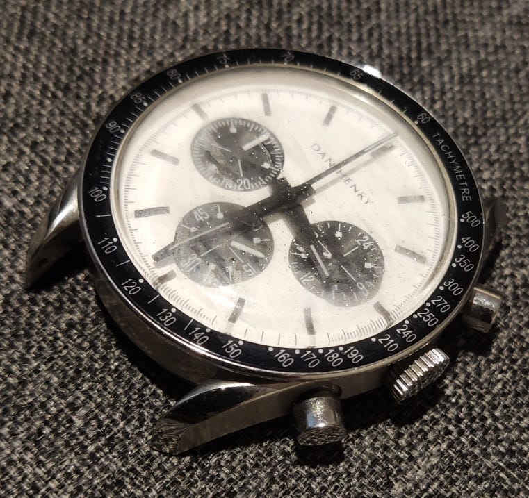

1 - 20 of 67 Posts
How much did it cost and how much do you love it?
The cost involved to dry it out and replace any damaged parts may be high.
Hmm... tough one here, I mean, in theory you would want a watchmaker to pull it apart and dry everything properly, if done quickly it'll probably be fine, although the dial and hands might eventually show wear that they wouldn't have otherwise.
But, the cost of the watch originally wasn't that much, so the cost to have it completely torn to bits and dried, then reassembled might not really be worth it.
So you might try just opening the crown, and case back ideally, if you have the tools, then taking a hair dryer and doing your best to dry everything without getting it too hot... of course remove the battery first, etc.
Or you could try putting it in a bag with rice, etc.
The right way is to take it for a service ASAP and just pay the cost... the less right way is to try and dry it yourself knowing that you might have to buy another one if it doesn't end up alright.
Best of luck with it!
It could likely cost more than the original price of the watch to repair it.
Remove the caseback, open the stem, place the watch in a shoebox, put a can of desiccant next to the watch and close the box. Wait a week. The quicker the better. Hope for the best.
That's the best you can do without spending more than the price of the watch at a watchmaker.
Reactions: ffritz and Mediocre
At least it remained intact! I agree with getting it to a watchmaker or at the very least opening it up to let it dry.
A few years ago, my wife left her Skagen in a jeans pocket and the washing machine totally destroyed it. It wasn't worth a lot financially, but it had a ton of sentimental value.
Take the back off take the movement out let it dry.
Remove the hands and dial throw the movemet out and buy a new movement for under $40.
Emergency care?
Submerge in 91% rubbing alcohol or in denatured alcohol. The alcohol will absorb the water. Keeping it in suspension. Alcohol has a neutral PH. Which hovers around 7.0.
Let it soak a while. Drain it. Then replace the alcohol and soak again. Once the water has been removed. Take it to a watchmaker. Because the alcohol will wash the watch clean of lube. as well as the moisture.
Notice how watchmakers will use alcohol as a final rinse to remove any water used during cleaning.
It is a 270 dollar watch, which puts it in the "through away" category. Even though it may work, for now, I would pitch it and buy a new one.
Yep that's my view as well, unless there is a real emotional factor that goes with it.
Water damage can creep up over time. A few droplets stuck in there can progressively f-up the internals. I would suggest taking it to a watch maker.
If it were me, I would probably just fairly confidently open it up, disassemble a bit and clean out the movement myself but if you are not familiar with this than suchexercise poses some risk.
On the plus side, it is not an overly expensive movement to just swap out if things do go sideways. In that case, I would be more concerned with the aesthetic components of the watch like water trapped in between or on top the dial, etc.
In any case, just letting the water sit and crossing your fingers is probably not ideal.
As most have mentioned, due to what a proper service would cost and the original purchase price of the watch, I would remove the case back and open/ unscrew the crown, then place it backside up in a ziplock bag of white rice. Be careful to keep the open side away from direct contact with the rice, close the bag and leave it for a day or two. You will be surprised how well this works!
Emergency care?
Submerge in 91% rubbing alcohol or in denatured alcohol. The alcohol will absorb the water. Keeping it in suspension. Alcohol has a neutral PH. Which hovers around 7.0.
Let it soak a while. Drain it. Then replace the alcohol and soak again. Once the water has been removed. Take it to a watchmaker. Because the alcohol will wash the watch clean of lube. as well as the moisture.
Notice how watchmakers will use alcohol as a final rinse to remove any water used during cleaning.
This.
Also remove battery first.
Rice will not do much as it is too slow. Removing moisture is top priority. Do not let it sit wet. If you let dry naturally it will corrode more, but still better than nothing. Maybe try some forced air drying...
1 - 20 of 67 Posts
