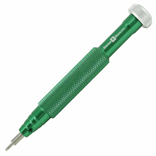

I know with the correct tools this can be done at home but I'd rather not risk butchering the screws on the bracelet due to tight tolerances or scratching the links in the process.

Just buy the right screwdriver and you won't have to worry about butchering it. You will have it forever as well, so worth it.

Watch some youtube videos about resizing your Rolex bracelet, buy the right tools and do it yourself.
If you are being extra careful use some masking tape over the screw head in case you slip. If you feel its too tight, blower or heat gun the screw. Once you have done it you will be resizing all your watch bracelets all on your own from then on.
#18 ·
It's easy to do with correct screwdriver. It's a little harder if you need to use the adjustments inside the clasp. The right tools including some form of magnifier works well.

same position as you a few months back OP, I had to resize my explorer and was apprehensive about damage etc, but have also seen the 'professionals' damage a watch during a simple link change, so I did it myself, after all if anyone is gonna scratch it I would rather it be me, plus I have done a few changes on other watches.
I did it and it was easier than other watches I have done, I did it a few times in fact (trying a link either side) to get a far better fit, and would not hesitate to do so again if I had to.
