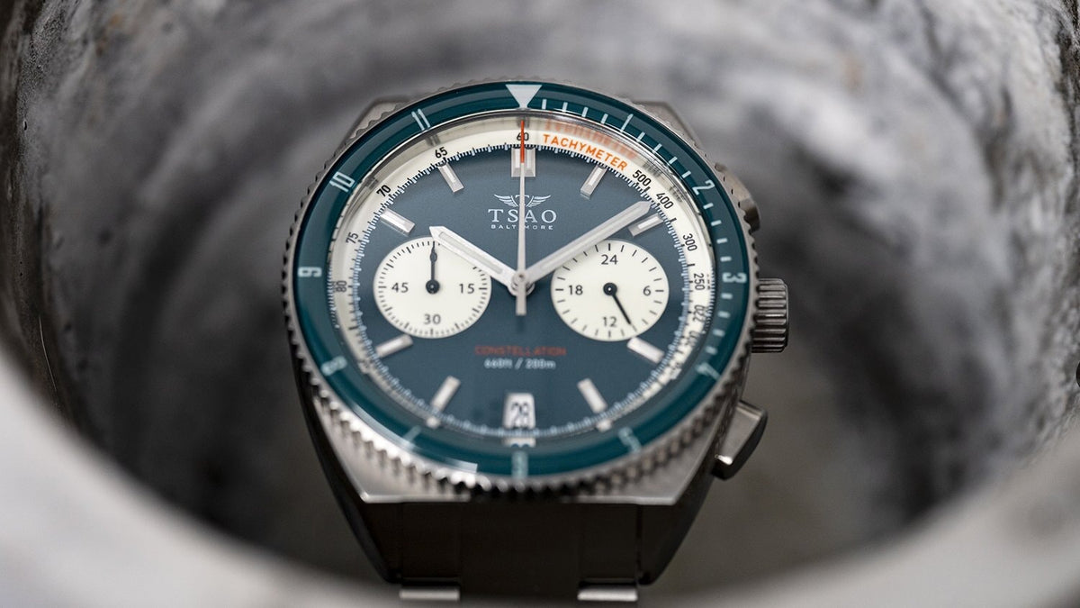

Closest I can think of is the Tsao Constellation: It's a Mechaquartz with a 60minute sub-dial, a 24 hour sub dial (day/night dial), no seconds, and a 12 hour bezel
I have one, and I like it well enough - but it may not be quite what you're looking for. That said, they're only $450.
