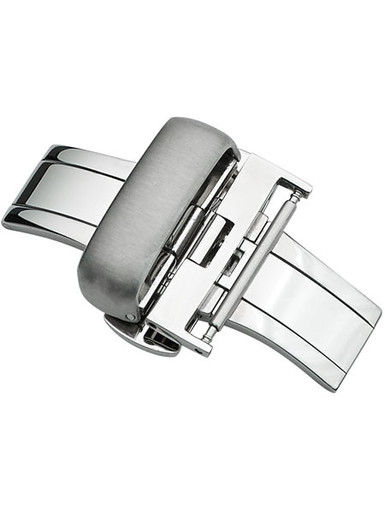

Just want to provide an update and share my experience.
Butterfly (dual-fold) clasps from Holben's Fluco, Long Island Watch's, and Hadley Roma are all similarly priced around USD $30. I decided to get Fluco clasp from Holben's because it is made in Germany. And I also bought Hadley Roma clasp from Amazon, made in China. Since I don't have experience with these clasps, I won't be able to tell good vs bad with just one. So wanted to have couple to compare. I can always keep both (if both are good), or just return one (if one is not good).
Summary: I like Fluco from Holben's over Hadley Roma (HR). The deciding factor is opening and closing action and feel.
Clasp action: Fluco's side-press buttons to release the clasp feel solid. When closing the clasp, Fluco has a sharp and audible click. When opening, Fluco ejects the butterfly arms with force. There is satisfying click when opening/closing the Fluco clasp. On the other hand, Hadley Roma has spongy feel when opening and closing the clasp.
Also, the part where strap's tang goes in, attach strap hole to pin, and cover plate flips close: Fluco's cover plate has a snap/click. HR does not close tightly with snap; it will open easily with little resistance.
To me, these actions and feel are the deciding factor between the two clasps.
Below are visual comparisons. There are differences on dimensions. But I don't see any of these are deal breakers.
Clasp closed: (Fluco on left and Hadley Roma at right. Note that HR does come with spring bar; it was not installed in the photo.)
The biggest difference is that Fluco has larger cover plate for strap's tang. This is something you can see when wearing the clasp. So this does make a visual or presence impact. Because I'm using this with a thick strap and tool watch, I like Fluco's larger cover plate. On the other hand, for those pairing this with dress watch, maybe smaller is better.
Clasp open, outside view: (Fluco on left and Hadley Roma at right)
Can see design difference on clasp latch mechanism. Fluco has 2 bars activated by the pushers. The butterfly parts have "hooks", which connect to the ends of the 2 bars. HR's design is quite common with most clasps on Amazon and Aliexpress. The pushers activate a pair of diagonally opposed hooks. The butterfly parts have square hole that mate with these hooks. As I mentioned, Fluco's action and feel are better. Not sure if that is related to this design or internal parts. If it is design related, then Fluco's latch design is better.
Clasp open, inside view: (Fluco on left and Hadley Roma at right)
On the size of side push buttons; HR is larger and wider than Fluco. I don't know if larger or smaller button is better. I believe the action or feel is more important than the size of the pushers.
Side view: (Fluco on top and Hadley Roma at bottom)
Just comparing the metal thickness (not the total clasp thickness), Fluco is thicker than HR.
Comfort: Minor difference between the two. I give slight advantage to Hadley Roma.
Macro scale (pressing into skin): HR over Fluco. This is not a problem normally. However, if watch/strap/clasp got moved off center or toward hand or palm, plus I flex my wrist and push my skin into the clasp, then Fluco's smaller push button will dig into skin more than HR's larger pushers. This might or might not occur depending on the fit of the strap.
Micro scale (sharpness): Fluco over HR. For me, the sharpness is not a problem at all. Still, I purposely run my fingers and wrist against the clasp to check for any sharp edge or corner. HR's push button corners are a bit sharp. And HR has wider push button, so more edge length to potentially cause issue.
Here are photos of Fluco clasp installed on RIOS1931 Chicago Shell Cordovan strap:

I'm glad that others find my post useful. I didn't find a lot of info online on deployant clasp, so just want to share my experience.
Below are close up photos of my Fluco clasps. This is the end that strap's tang (hole-side) go into. I will just call this U-shape piece "cover plate"; not sure what is the technical term. This cover plate is held tight using friction.
To take the photo, I opened the cover plate. It is actually very tight and hard to open. It took me multiple tries to open this. In normal wear, I never open this cover plate. Only reason to open this is if I change strap or I need to adjust the length by going to another hole. Since I won't open this in normal wear, I cannot imagine this coming lose over time.
In comparison, on Hadley Roma clasp from Amazon, cover plate will open with little resistance.
In this 1st photo, you can see there is a divot on the inside corner of the cover plate. There are divots on both ends. On the opposing piece underneath the cover plate, the edges are not flat. This closes/mates with the divot thru friction.
In this second photo, just want to show that the pin for strap hole is quite small. So this pin does not hold the strap in place, unless the cover plate is closed.
When the cover plate closes, the strap is held tight.
I don't have the problem that Holben's review had. If this cover plate is lose, that is a big problem and clasp will not wearable. The strap can slide; pin will scratch inside of the strap. Worst case is a safety concern that strap can open up.

Just received my Fluco deployant clasp today. Unfortunately, I'm not all that impressed. As far as quality is concerned, it doesn't seem lacking at all. Nice pushers. The metal seems milled very nicely. There is a clear audible click when closing, and it springs open when I deploy. My disappointment comes from the considerable thickness that this adds to the clasp side of my wrist. I took my caliper to it just to see what we are working with here. Depending on where measured from, this thing is between 12 and 13 mm. Boy is that thick. Just for reference, the watch/strap I put this on is my TAG Aquaracer, with a case that comes in @ 12mm thick. That mean I'm essentially wearing a watch on both sides of my wrist. Ok, ok, I exaggerate a little here, but certainly too thick for me. Maybe it's because it's a double deployant rather than single. Just for further reference, I recently purchased a Seiko Alpinist which came on a decent leather strap with a very nice single deployant, and at it's thickest, that thing only 7mm. Needless to say, it's not very comfortable on wrist, and I have contacted Holben's to see if thereis any refund in order. If not, at least it wasn't all that expensive.
Save
#25 · (Edited)
Good catch @JaseRicco. This deployant clasp is indeed thick. After seeing your post, I measured mine using a caliper too and you are right - 13mm. Holy smokes! I first noticed the thickness when I put the watch in my watch box as it sat high but I would not have guessed 13mm. No way around the fact that this is a thick boy. For comparision's sake, I measured the Bear Uhrband Gmbh DF1 double fold push button I have on my Mühle Glashütte and the Bear Uhrband is just over 10mm.
That said, I've been wearing the Fluco deployant clasp all day today. I put it on just before 9am and am still wearing it as I write this 7 hours later. This is far longer than any of the Amazon clasps I have. Thankfully, the thickness is not bothersome to me and the comfort is probably my biggest "need to have" measure. Maybe because it is short sleeve weather? Maybe it will be different if I have to wear a long sleeve shirt with it? Time will tell.
