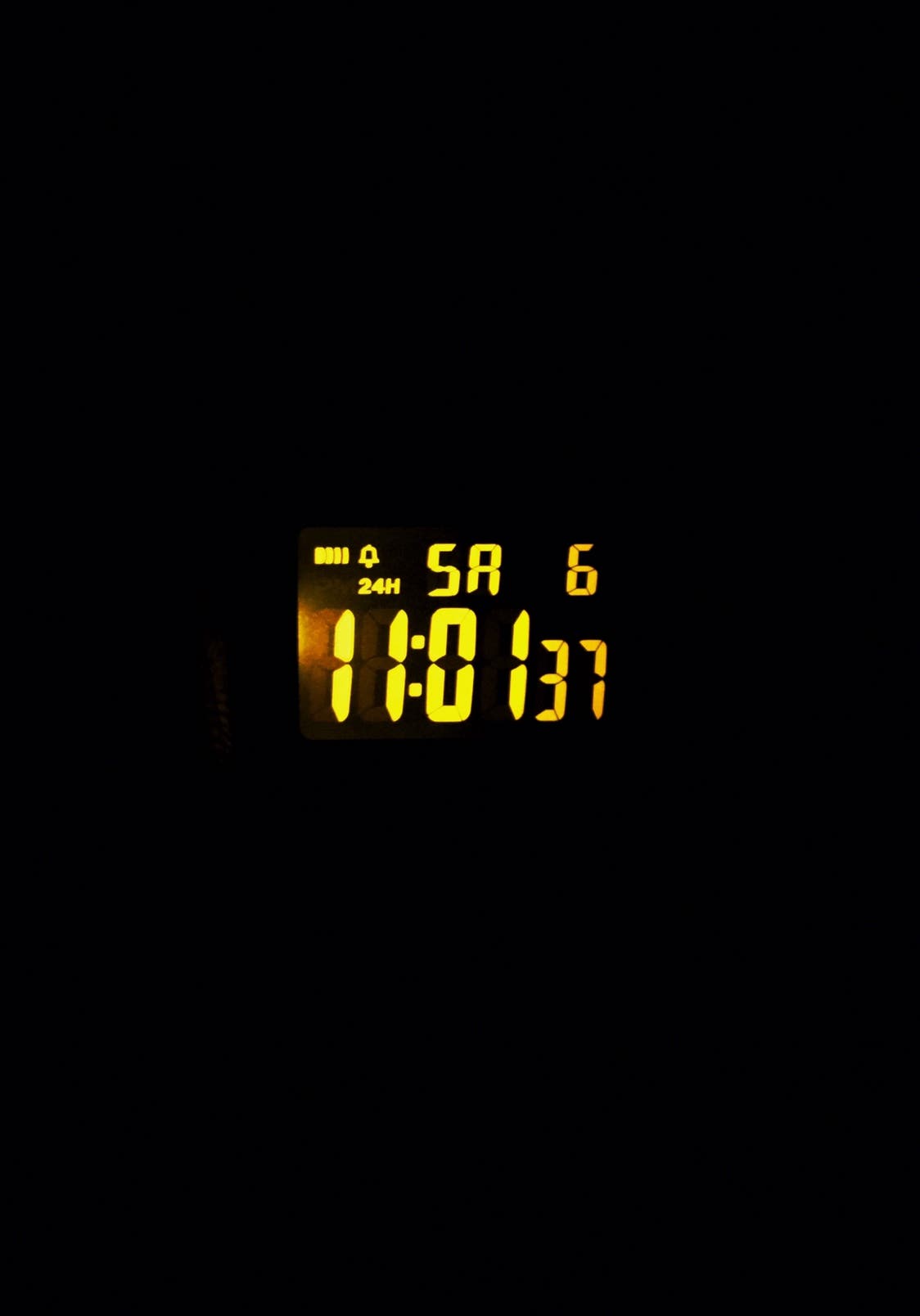

Funny enough though the backlight on the positive module 3454 from the W217 is like the negative version from the B650 where only the digits are illuminated and background is black where as the positive module 3224 from the W218 has normal backlight with black digits and amber color background....and the smaller digits.

Here is backlight of positive display module 3454 from W217
