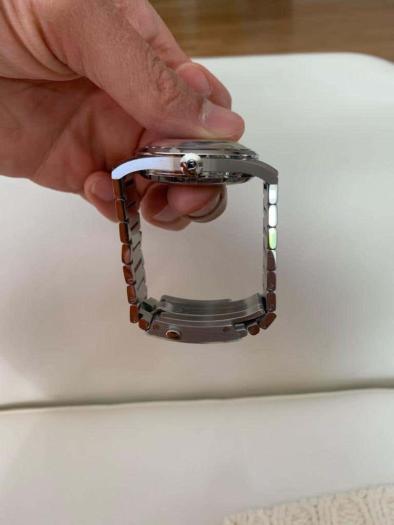

Does anyone wear their watch with the clasp centered from the case, or is it off center, like the clasp is closer to the 6 o'clock side (or shorter on the 6 side than the 12 side)? Mine is dead center, with 9 links on the 6 side and 10 links on the 12 side.
Which is correct? Dead center clasp or off center clasp?

Shorter on the 6 side by a link or so for a better fit. Oddly, this centers the watch on the top and the clasp underneath the wrist on most people. A little trial and error will tell you how much to bite off to start, then you tweak it. After doing a couple you'll get a feel for it. Plus you'll have templates.

#16 ·
Every bracelet watch I've ever owned would rotate toward the outside of my wrist if the clasp was left in the position it was in when purchased. I move as many links as need be to make the 6 O clock (bottom) links at least 2 links shorter than the 12 O clock side of the bracelet. With the clasp dead center on the underside of my wrist my watches (all 2 of them) remain top dead center on my wrist.
This was not so critical with my Carrera cal 5 watch because the new model bracelet has a much smaller clasp but the bracelet still required link swapping.
If you are not equipped or not a finesse person be very careful with your DIY work. If you have the dealer adjust them for you make sure it's correct before leaving the store.
