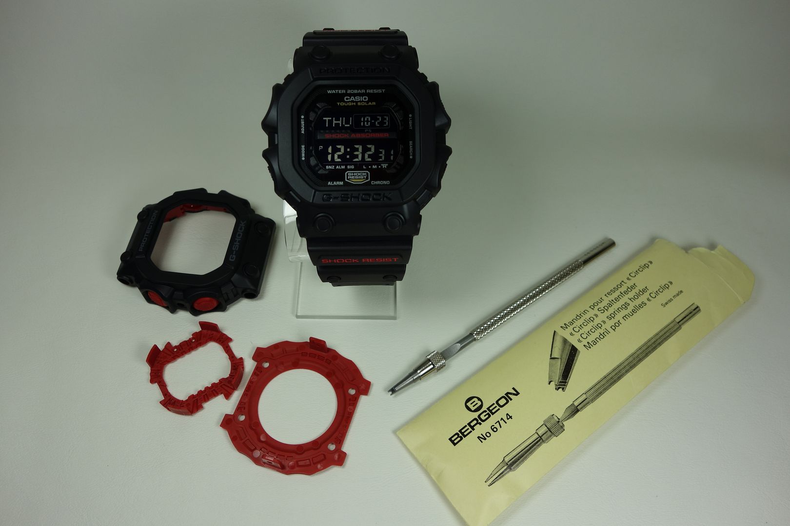

#5 ·
While it is not a necessity, I have found the tool pictured below to be immensely helpful when both removing and installing E clips. It eliminates the need for the plastic bag method when removing the clips because it firmly grasps them, and it positions the clips perfectly for re-installation, making the process much easier imo. I picked mine up on the bay, but I don't see any available at the moment. With some luck and persistence you might be able to track one down. Definitely worth the $40 or so I spent on it.
#6 ·
@Knives and Lint - I saw that tool on one of yours and LUW's threads regarding the button clips. It's looking like it's the way to go for these sorts of projects; I may have to do a couple of restorations to help justify and pay for it, but that's not so bad is it?
Would you have any comments on how necessary the job of lubricating the button gaskets is for either maintenance or restoration, or an idea as to the size of the clips?
#7 ·
there is a tool for E-clip that a member TixTox or something posted a while back / I have a few donors Gshocks laying around so I don't worry about losing Eclip
reinstall is always harder than taking it off, you need to have good eyes or invest in some kind of watch-maker's glasses / more me, it's hit or miss kindda thing, and I believe practice makes perfect and depends on luck
