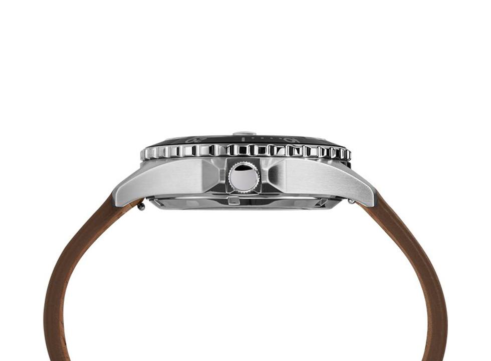

There is no way to look at this watch at this price point and not instantly start comparing it to the newly released Seiko 5 divers. Throwing in at a pre-owned SKX also wouldn't be a stretch comparison. Measured with my calipers, the case of the Navi XL comes in at 41mm in diameter (excluding the crown), 51mm from lug to lug, and 13.7mm in thickness. It's chunky in relative terms, but it is still 1mm thinner than a Tudor Black Bay at 14.7mm (this dimension was the deciding factor that led me to sell my burgundy bezeled beauty).

The Navi XL Automatic , with its stainless-steel case and exhibition case back, is classically shaped: the top and sides are nicely brushed and its case underside is polished. The inside of the lugs is polished, as well. On the case, in between the lugs, is a thoughtfully placed indention allowing thicker straps to fit. Another notable (and very unusual) feature is the case back's outer rim which is stamped with the lug width "20mm". A very common size for one to experiment with straps or bracelets you already own. The distressed leather strap it comes with is super comfortable right out of the box, and is aging nicely.
