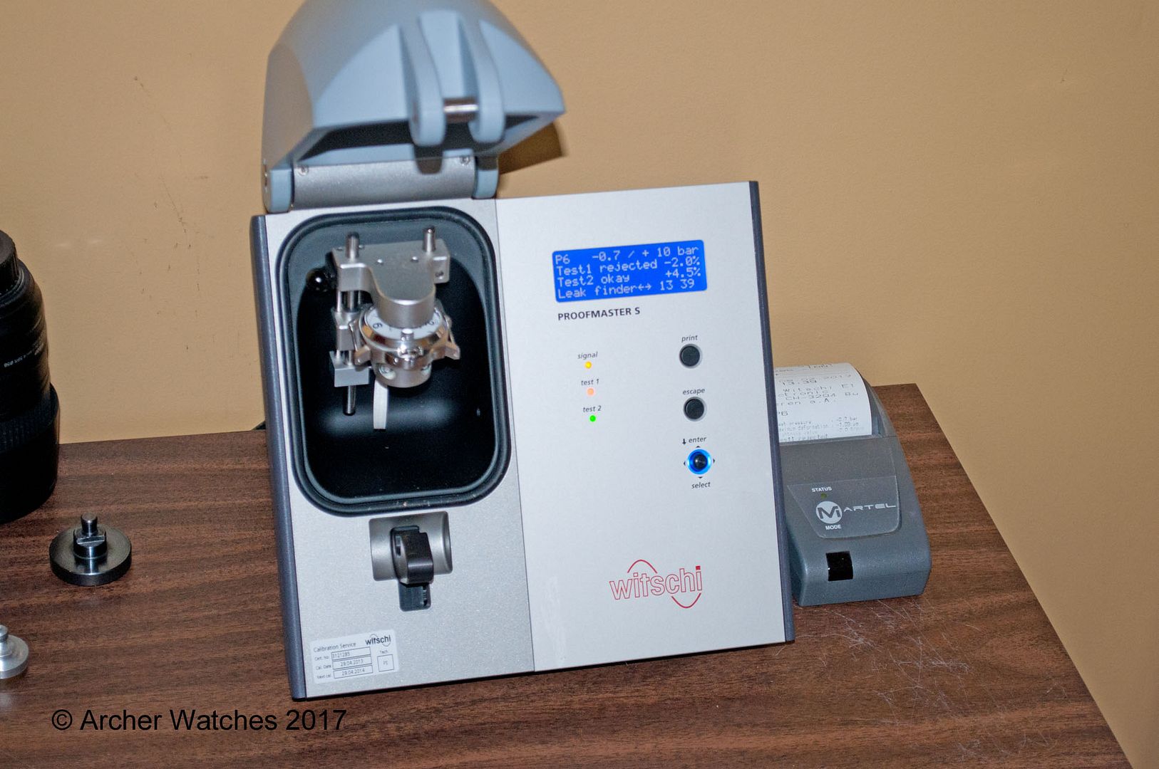

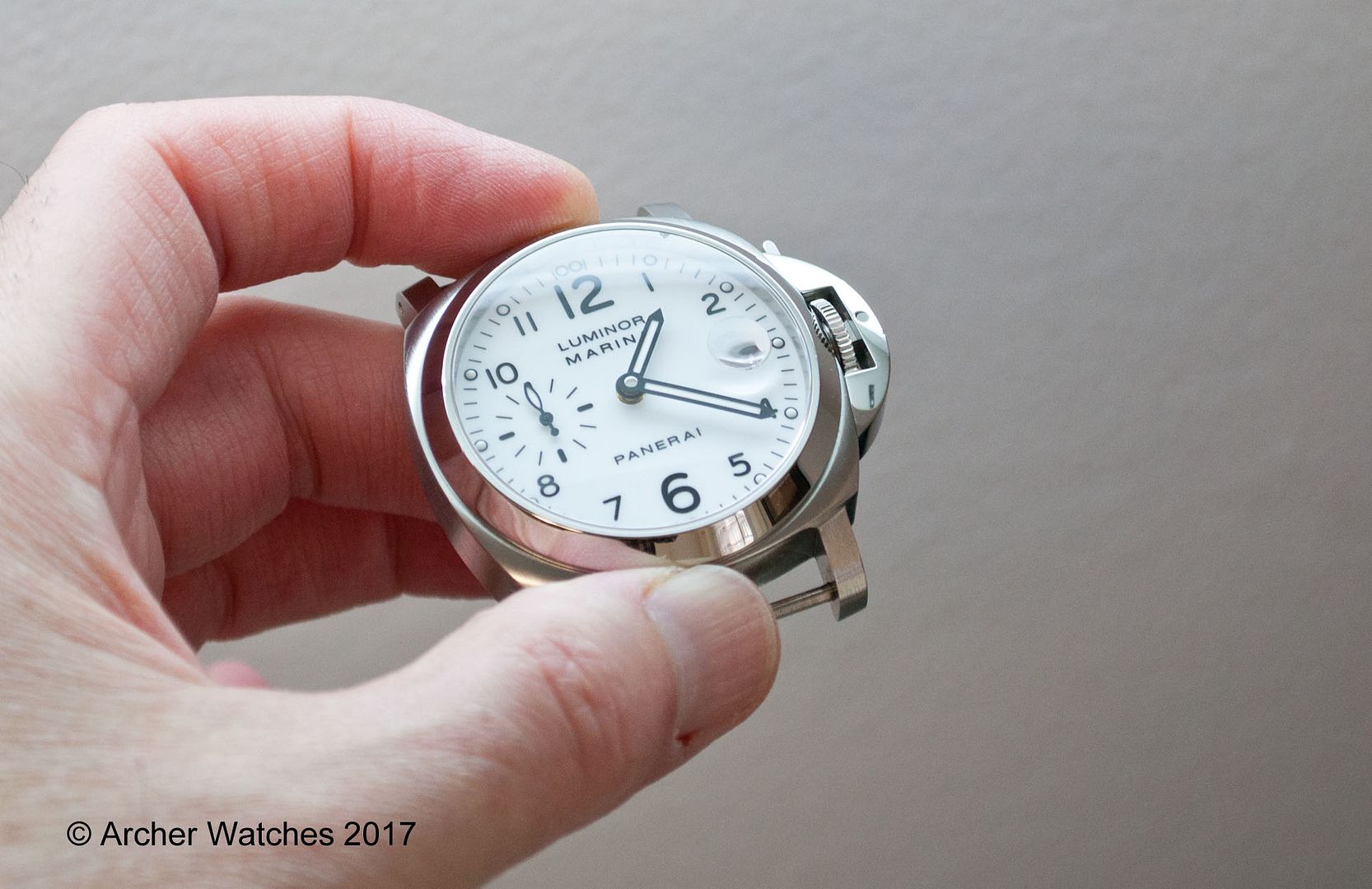

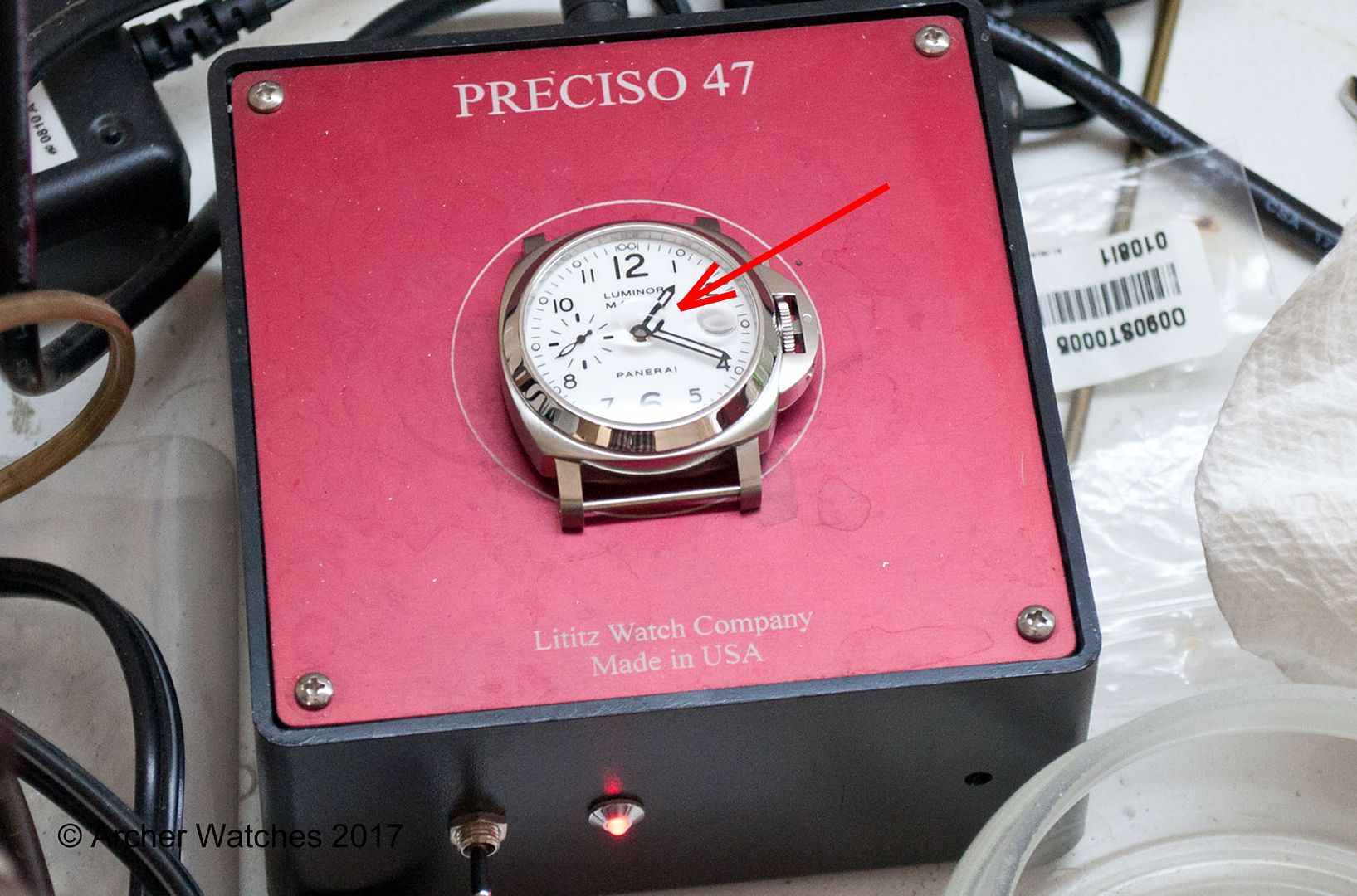

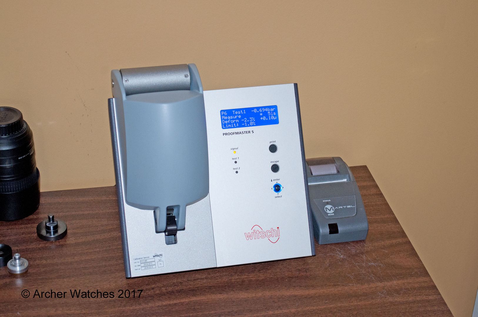

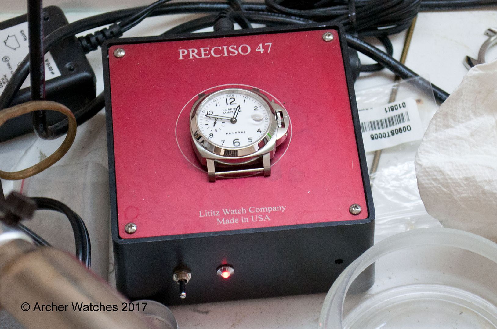

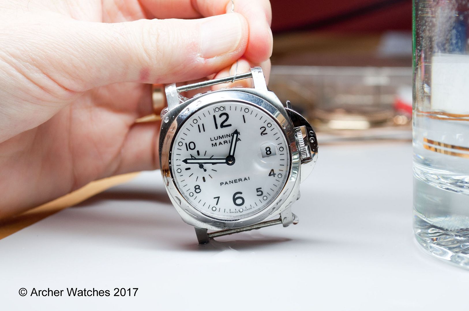

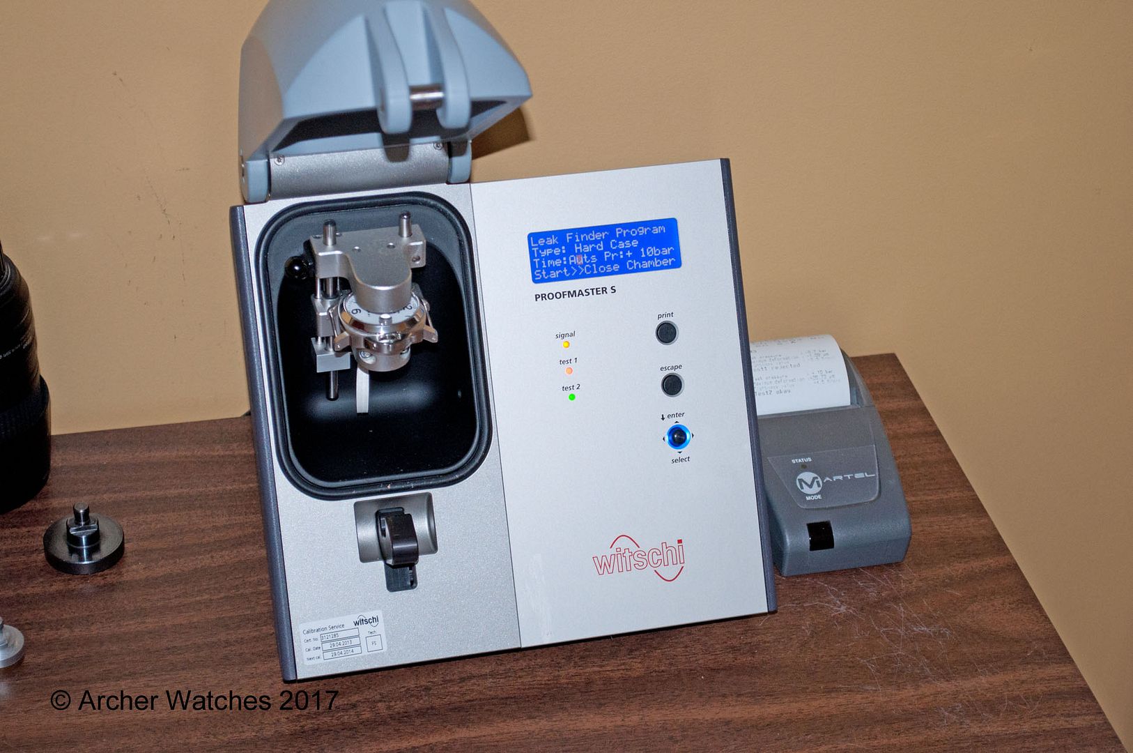

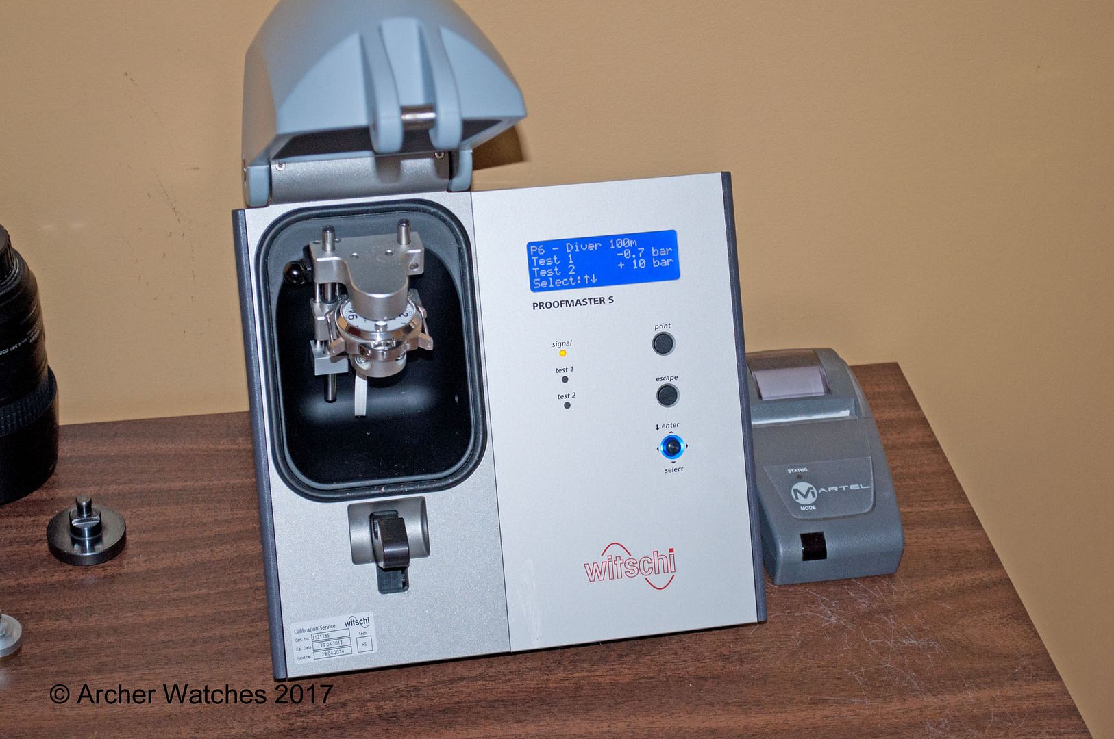

#15 · (Edited)
It relies on deflection, and yes some watches can be so rigid that my dry testing machine will reject the vacuum test, but it rarely rejects the +10 bar pressure test for that reason. That usually happens when a watch is rated for extreme depths, like 1000 m or more. Here's an example of how I handle a situation where the case fails a vacuum test, and I need to confirm that it is still sealed. This is my dry testing machine that uses vacuum and pressure for testing water resistance - set to the dive watch program, which is the most demanding setting,. It starts with a -0.7 bar (gauge obviously) vacuum, and then a +10 bar pressure. The watch in question is a Panerai 049, rated to 300 m:
During the vacuum test I can see that the test is going to fail based on how the numbers are going - note that the level of deflection being measured here is very small as this machine is extremely sensitive:
Watch failed the vacuum test, and passed the pressure test:
For watches that fail either test, I can perform another test on them using a program called "leak finder." This pressurizes the watch for en extended period of time, and closely monitors the deflection:
The machine is checking the deflection to an even higher degree than in the initial test, to determine if it's safe for a water test - this one is:

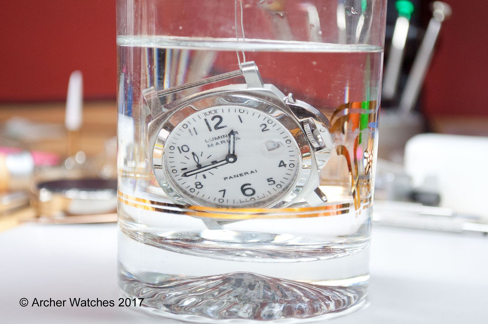

I then submerge the watch in a glass of water, and watch for bubbles like you would in a cheaper wet testing scenario like the OP is simulating with his home made device:
No leaks:

I know there is this idea you are suggesting that the results of a dry test will be a mystery, but if you work on watches daily as I do, there aren't going to be any surprises about the water resistance of a watch you are working on. Based on the condition of the watch, knowing how the testing process actually works, and loads of experience you usually know going into the test how the watch is likely to perform. So in the scenario you presented, I won't be left scratching my head deciding if the watch is too rigid or is leaking - that will generally be pretty obvious to someone with experience.
And of course I do have testing equipment that will go far beyond 10 bar - my wet testing equipment can test to 125 bar.
But the dry testers are much more than the example shown above where a dial indicator is resting on a crystal. In addition to being much more sensitive than that is, these machines don't just measure overall deflection, but the rate of the deflection change, and what the pattern of change is are also looked at in the software. Parameters are set for all sorts of case information, such as crystal types, diameter ranges, etc. I have programed custom tests on this machine for situations that are not covered by the pre-programmed tests.
Hope this helps.

9) Once the container is depressurized immediately dunk the watch into the water so it is fully submerged. Here I have just set the housing on its side. The watch will then sit on the side of the housing sitting in the water.
Here is a close up of what that looks like:
If there are no leaks, it will look like the above pic (no bubbles coming from the case) In a way it is a little disappointing as nothing is happening. LOL
You should be happy to see no bubbles though as this means your watch is safe!
