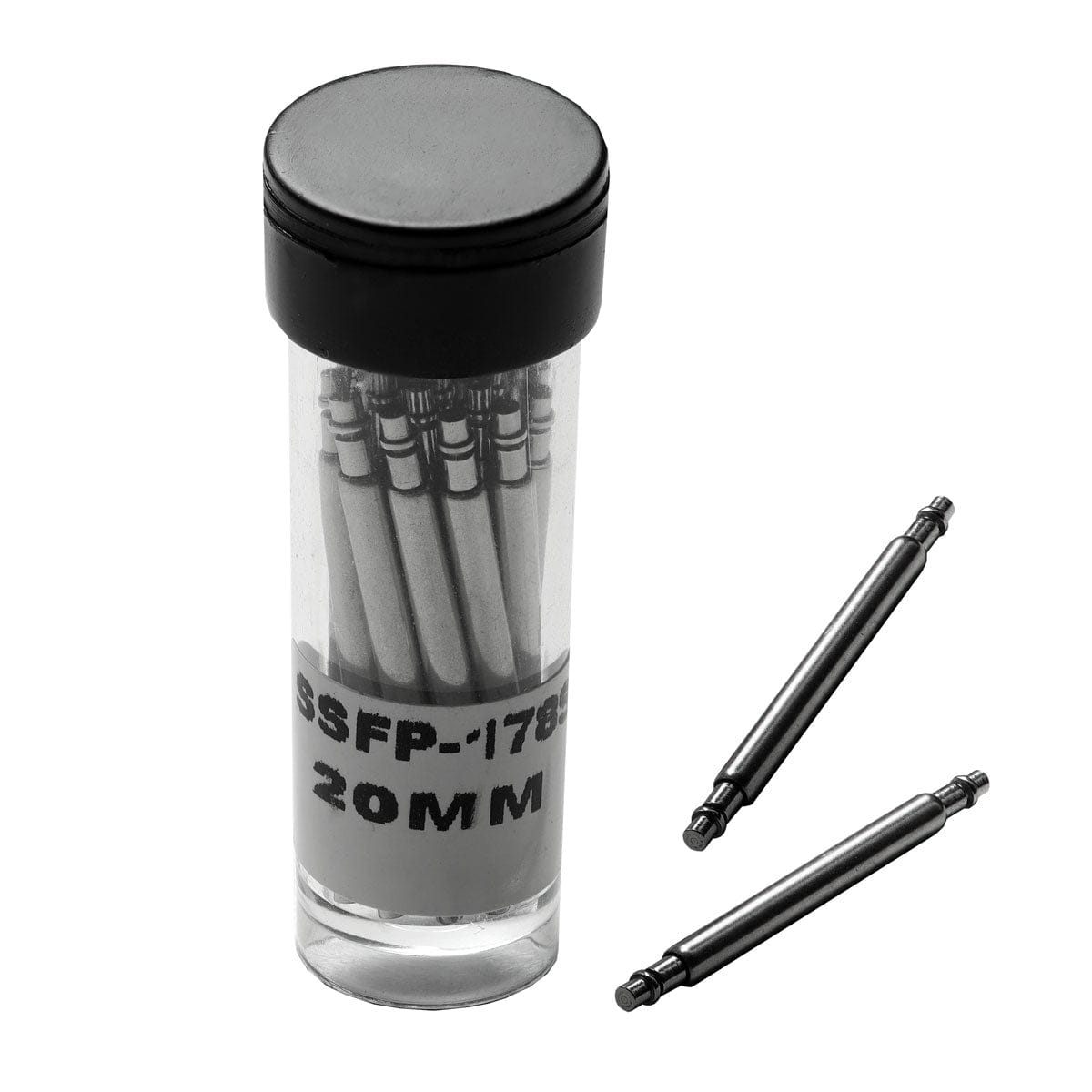

The best option I could find was on eBay through outletgoods. They are labeled as single shoulder 18mmX.9mm. Crafter blue also makes a strap for this watch that comes with spring bars. I assume they will be a perfect fit. Here are the eBay bars.
Be sure you have drilled lugs though before you use this type though.
