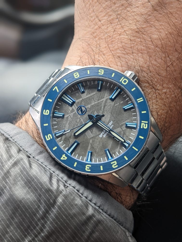

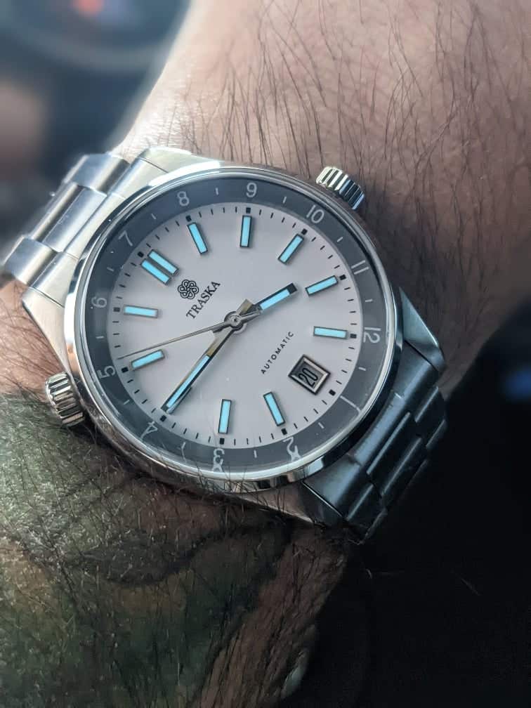

Hardened bracelets and cases, they are starting to be more common but still not as prolific as one would think. I currently own two watches with what I assume are similar in process. Both are affordable watches and both look like new after constant wear in a rotation. Most notable are the clasps that look new. If this can show up on under $1k and even $500 watches... I would think we as consumers would push for it more. The two I am referring to are Zelos and Traska pics below.
