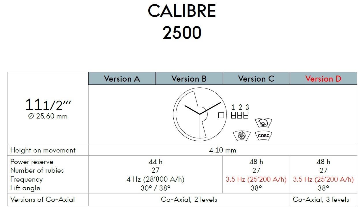

For those who may doubt this, here is the information from Omega, and you will see that the D is the only version of the 2500 that is noted to be 3 levels:
Now Mike does give a rather disjointed but accurate view of the issues with the 2-level escapement's lubrication. Sticky black residue forms on the intermediate escape wheel teeth, and the co-axial wheel teeth of all 2 level escapements. This is what eventually stops the watch.
Unlike the 3313 that Omega chooses to upgrade, they do not upgrade the 2500 calibers to the 3 level design.
