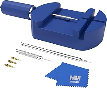

#5 ·
You need a link removal tool that works like a vise. They are very inexpensive on Amazon.
Something like this:

#10 · (Edited)
I can't be completely sure with only that photo to look at, but I'm pretty sure that what you need is one of these:
The pin removal tools mentioned above will not work. You might get away with using normal needle nosed pliers or a small screw driver but the sliding part of the link is usually very tight and will risk damaging the link.
#12 ·
This is true. The link pin removal tools are for the round split pins. His bracelet is just as described above.
