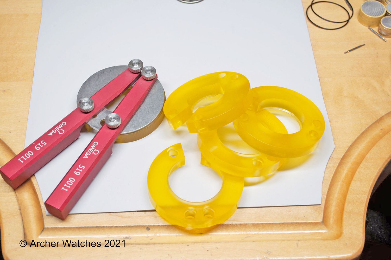

I've used a number of tools for removing rotating dive watch bezels, and the "grip and twist" styles tend to work quite well in my experience. This is an Omega version, but there are others available out there from Bergeon, etc.
Cheers, Al

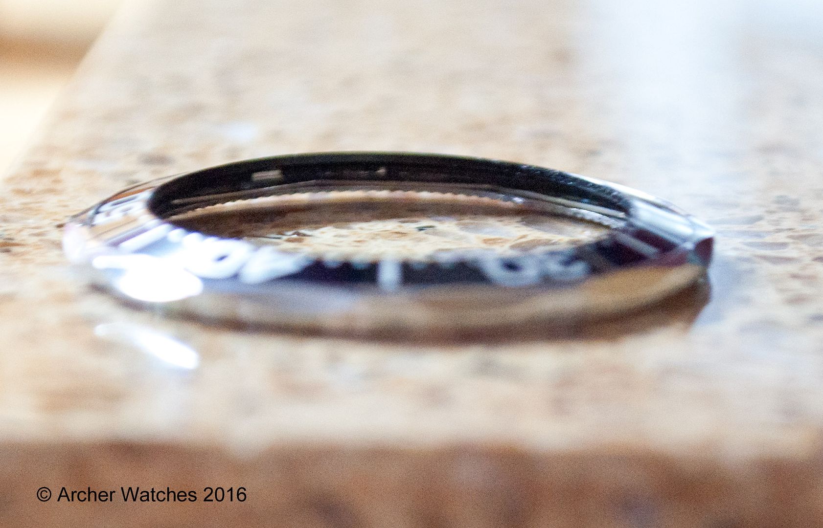

I've always cringed when people say to pry it off with a knife. I've seen too much of this to believe that is a good idea, at least in all cases.
In addition to bent up bezels like the one above, I've seen cases damaged by the back edge of the knife on the lugs, and the surface that the bezel rides on all chewed up because the inserted the knife too deep and just prying the crap out of it.
So in addition to the one I showed above from Omega, I've used this one as well:
