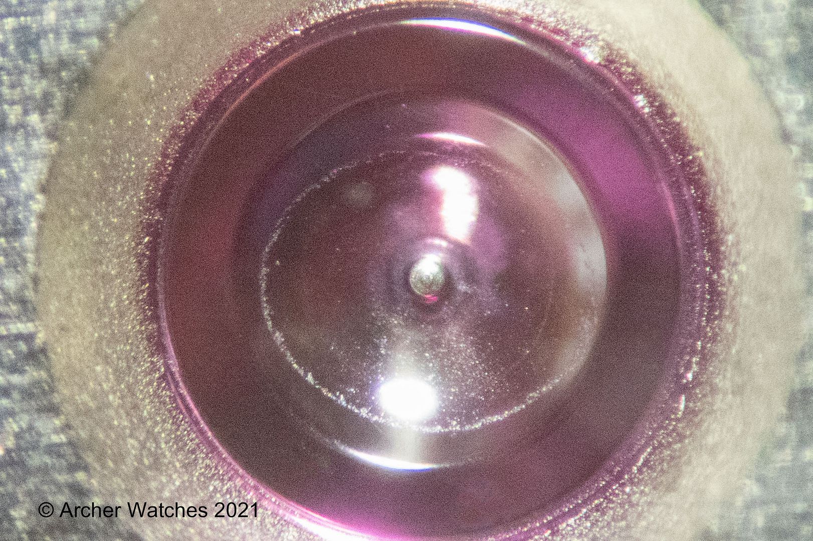

Modern synthetic oils don't really "congeal", they just dry up completely and leave a dry residue behind, like this:

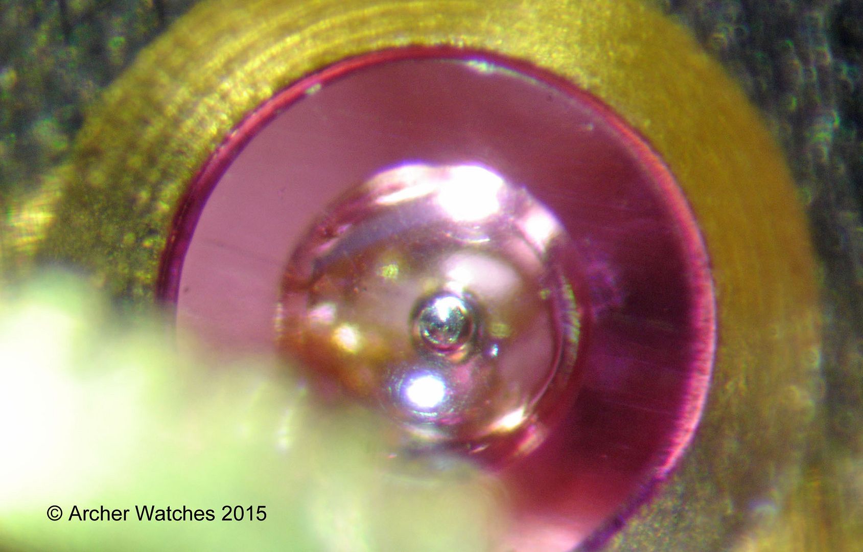

The older natural oils would certainly congeal, so the lighter elements evaporate first, leaving behind the heavier elements in the oil - that looks like this:
This residue is very sticky, and can actually become quite firm over time - here's a balance jewel in a watch and in this case the oil has migrated to one side:

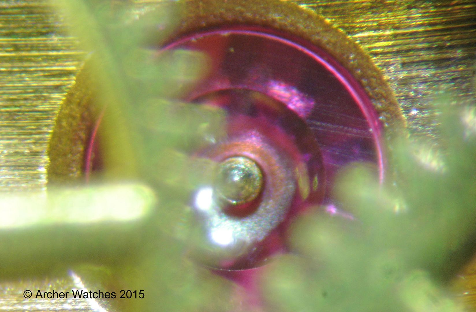

That oil is not liquid anymore, so when I took it apart, it was self supporting:
These older natural oils would break down quicker than modern synthetics, and the gummy nature of them would actually stop the watch. This is sort of a good thing, as it prevents damage from running the watch when the oils are gone. Modern synthetics just let the watch run and run - this is why performance of the watch is not a good indicator that everything is fine inside.

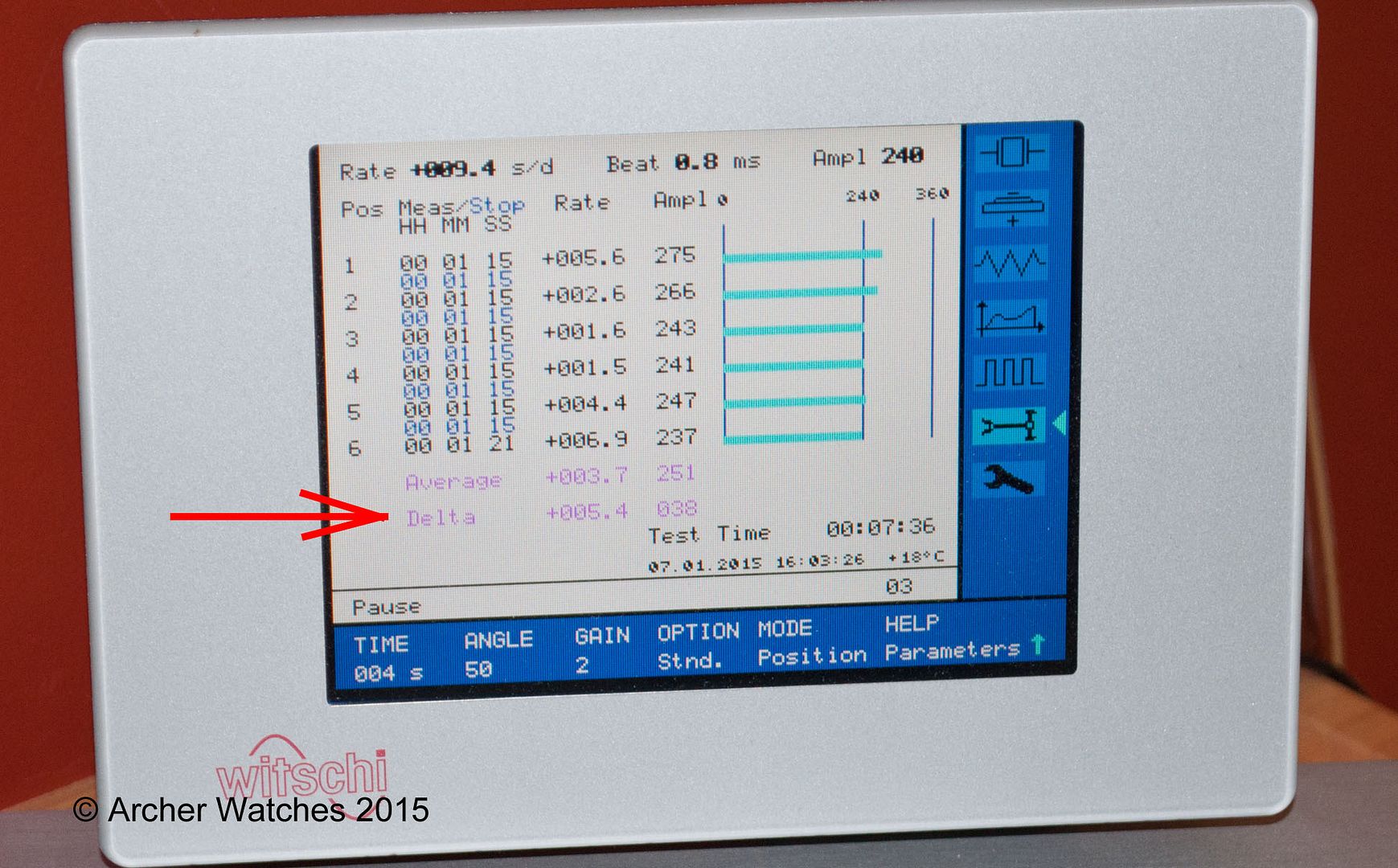

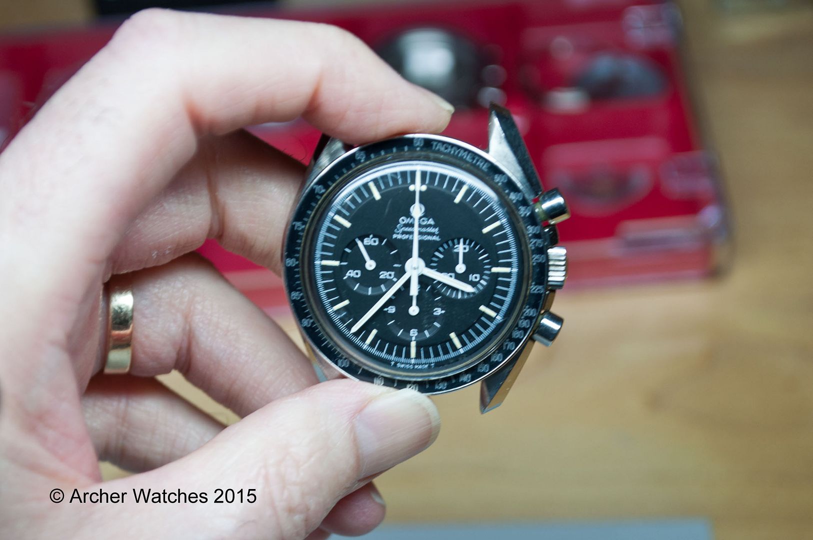

Just to illustrate, this is the 1971 Speedmaster I'm wearing right now, but when I first bought it:
It had no service history, so I fully wound it, and performed timing checks over 6 positions, at full wind - these are the results:
So the Delta at the red arrow is the difference between the fastest and slowest positions. At 5.4 seconds, this exceeds the requirements for COSC and METAS watches. The average daily rate is 3.7 seconds, so if I were to just go by this, the watch is running fine - amplitude is a little low, but the rest is perfectly fine.

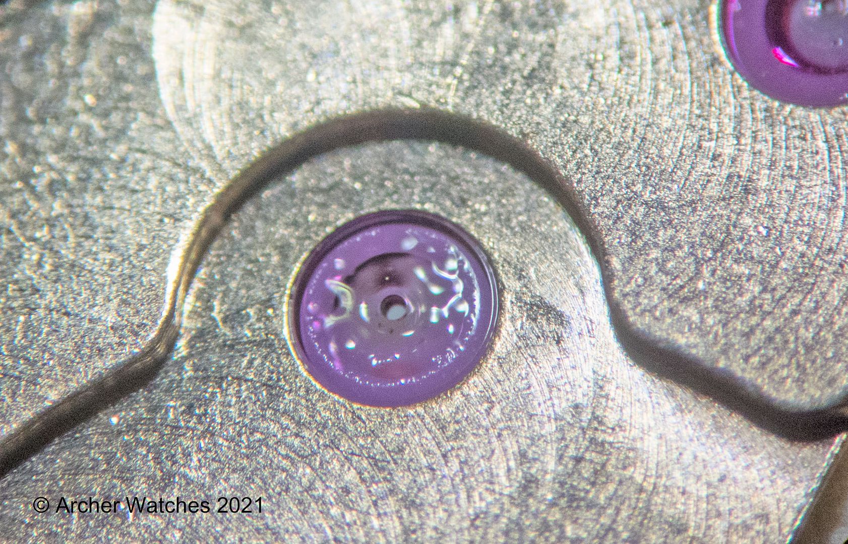

So I opened it up to take a look at the condition of the movement. The jewels were all dry - no oil here:
Here in the third wheel jewel, you can more clearly see that the oil is dry:
When I serviced the watch, all the jewels were completely dry. So a watch that is dry can not only run, but run well. Timekeeping is not a reliable indicator of the condition of the movement. Having timekeeping problems can certainly tell you that something is wrong, but the absence of timekeeping problems doesn't tell you that everything is right.
