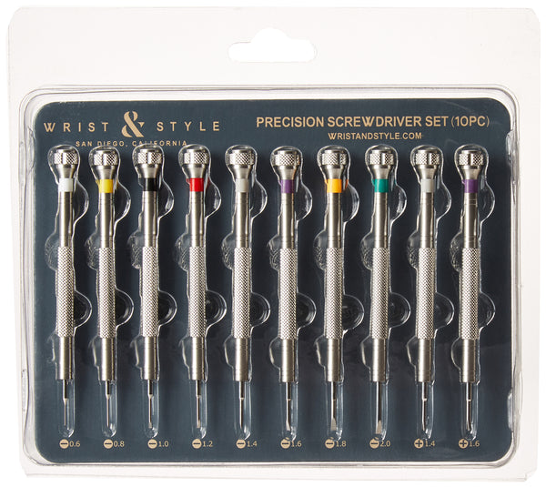

I read other threads saying these are good in between. I bought a set, actually arrives today, we'll see.
I've had this set for quite awhile and am absolutely pleased with them. I too had the idea that if the drivers were good, I could always change out the blades for Bergeon or better, but have not found the need. Below is an image via my scope before shaping or sharpening on my Arkansas stone.
  • Helpful
Reactions: 10mm and vmgotit
