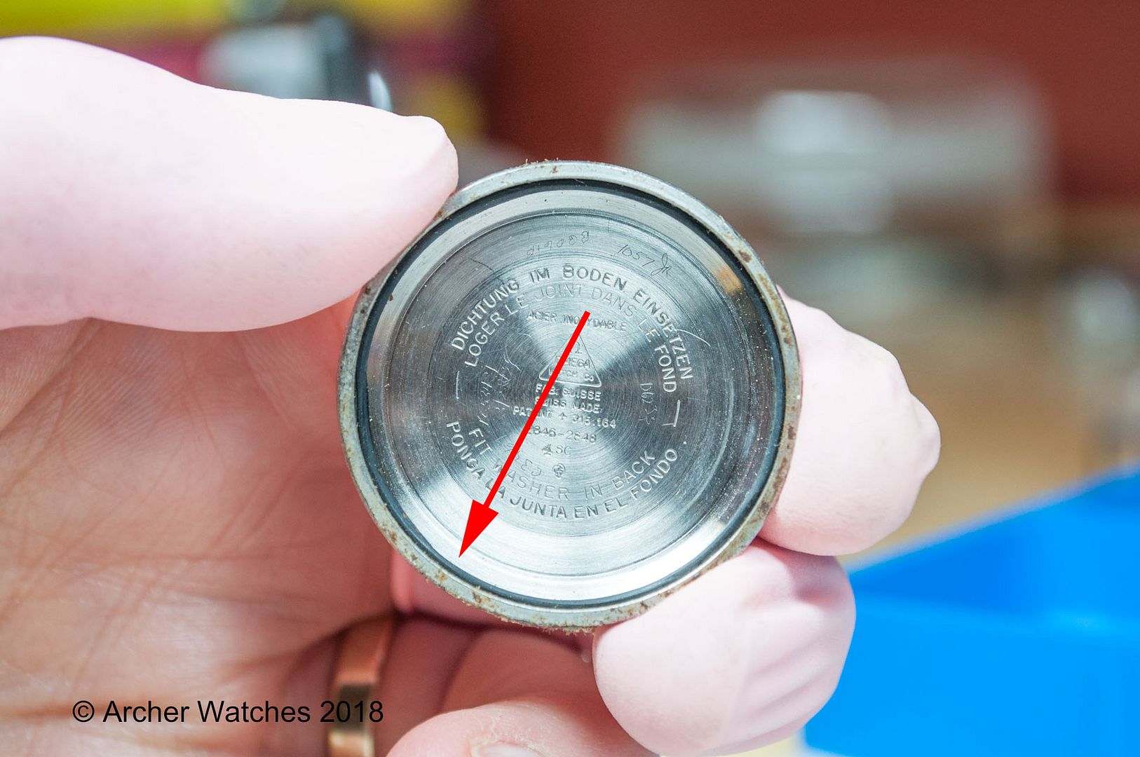

Here's some examples...vintage case back where the O-ring goes inside it, and then the case back snaps in place:
These work when the sealing surfaces are in good condition, but are not capable of high water resistance ratings generally.

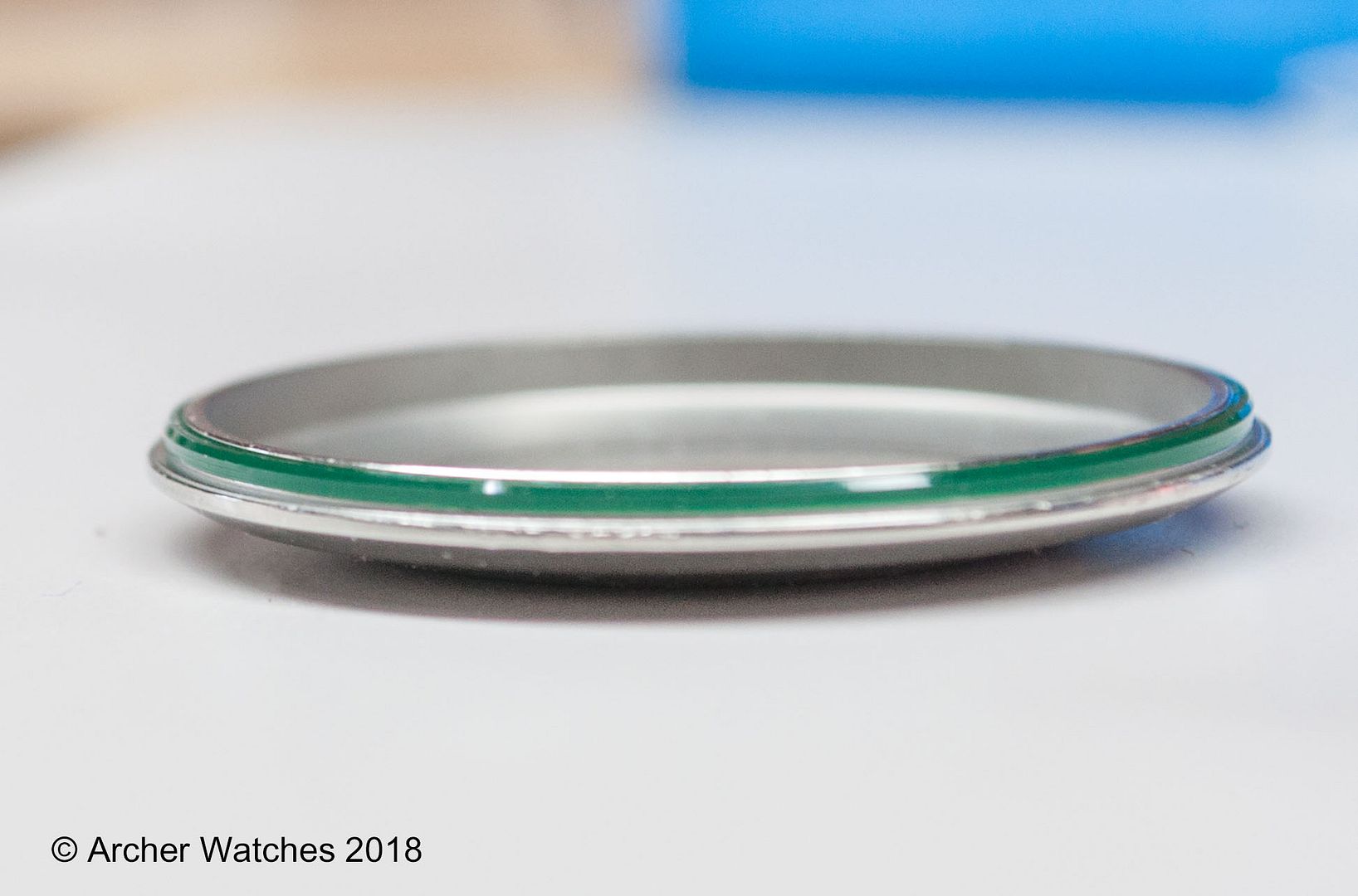

People who claim that they "don't work as well" do miss a key point though, and I'll illustrate that with this design:
This is a press fitted case back that uses a hard plastic gasket. When the case back is pressed in place using a press, that gasket is compressed and provides a very strong and tight seal. People may think "But it only presses in place, how good can that be?" Well, this is the exact same way that the crystals of a typical dive watch are held in place. A hard plastic seal that holds the crystal in place by compression, so if it can work for a crystal in a dive watch rated for 300 m, 600 m, or more, it can also work for a case back...
Just like pressing the case back in, it requires a heavy press with good dies, and the forces required to press these in are substantial:
I would argue that a press fitted case back of this style, with a hard plastic gasket is actually far more consistent with how it compresses the gasket than a screws down case back that can be under or overtightened. In the case of a press fitted case back like this, there is no guesswork - you mount it, press it until it seats, and the design takes care of the rest. No need for torque specs like there are for screw on case backs.
