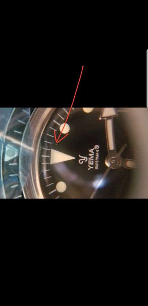

I've had my eye on yema watches for a while and I think they have a great design and also my family history being French makes it awesome! So ordered a superman got home so happy to see it but it had two flaws that I have noticed.
1) First started out with bezel alignment issue which drives me crazy.
2) I found a piece of dust or something on the dial!
I attached some pictures to show. Customer support said they didnt see anything with the bezel but did agree with the dust and said they would talk to QC tomorrow. What a big let down so far...

I reckon you are overreacting indeed. I'd do exactly the same though. You've probably set the bar so high for this watch, you wanted to love it so so much that a tiny, simple detail "ruined" it for you.

#17 ·
so, when one or two of the markings line up, others don't, right?
that's how it looks to me,
not a matter of misalignment which, since you have a bezel lock, could be solved by locking it between clicks,
it's the spacing between the markings that's not well measured.
it's your call as for how much it bothers you,
in my case, since the glass is domed and, by itself, will always give off that impression, I think I could live with it,
but it isn't right, no, and nothing they couldn't easily do better
#16 ·
This is yema reply to me:
I showed the photos to the technical department..
Here is the explanation I received:
The bezel alignment will never be 100% correct as the bezel is not symmetrical. You will always have a very minor misalignment on the left or right once it 'clicks' in place. To get a perfect alignment, you will need to place it between the clicks. Then tighten the bezel lock as it stops in the middle.
This is the only solution and no more adjustments can be done on our side as it is constructed this way. The Superman Heritage bezel compared to other watches is actually more precise as it has 120 divisions to the 60 divisions on others. .
Like mentioned last time, we had 0 complaints before on this issue. Most people seem to have and see a good alignment and we've never received a complaint about this before.
But we perfectly understand your point.
This is the best we can achieve at the moment.
Please let us know what you think.
Regards,
Looks kinda off on their website too, nothing seems to align properly. What a ridiculous design to not have it symmetrical.
#21 ·
I appreciate the honesty in their reply. Sometimes you can’t just make everybody happy. Sometimes a solution just isn’t there and is virtually impossible.
BUT, their reasoning is crap. First, why in hell would a bezel be asymmetrical? Second, they’re acting like they’re the only ones that use a 120 click bezel. They could have at least come up with some “our watches are assembled by hand” line or something.
I see the misalignment. In fact, to me looks like the lume pip is off-center to the right. I’d be done with them.
#283 ·
I think they are talking about symmetry relative to the dial. Not exactly the correct wording, I don’t think, but for example if you took a slice from 9:00 to 3:00, split them apart, and compare you’ll see the relationship of the bezel position to the dial is not the same. The bezel appears to be round, but the insert appears to be slightly shifted towards 6:00 when looking at the watch as a whole.
That said, while the alignment at the pip does not bother me, the bezel being shifted down like that would. The bezel lock cannot fix that as it is a function of construction execution.
Unfortunate.
Edit - I see another post above where the bezel appears to actually be shifted up slightly relative to the dial. Pip in photo appears dead on, however.
Looks like they have a minor QC issue with centering the bezel insert.
