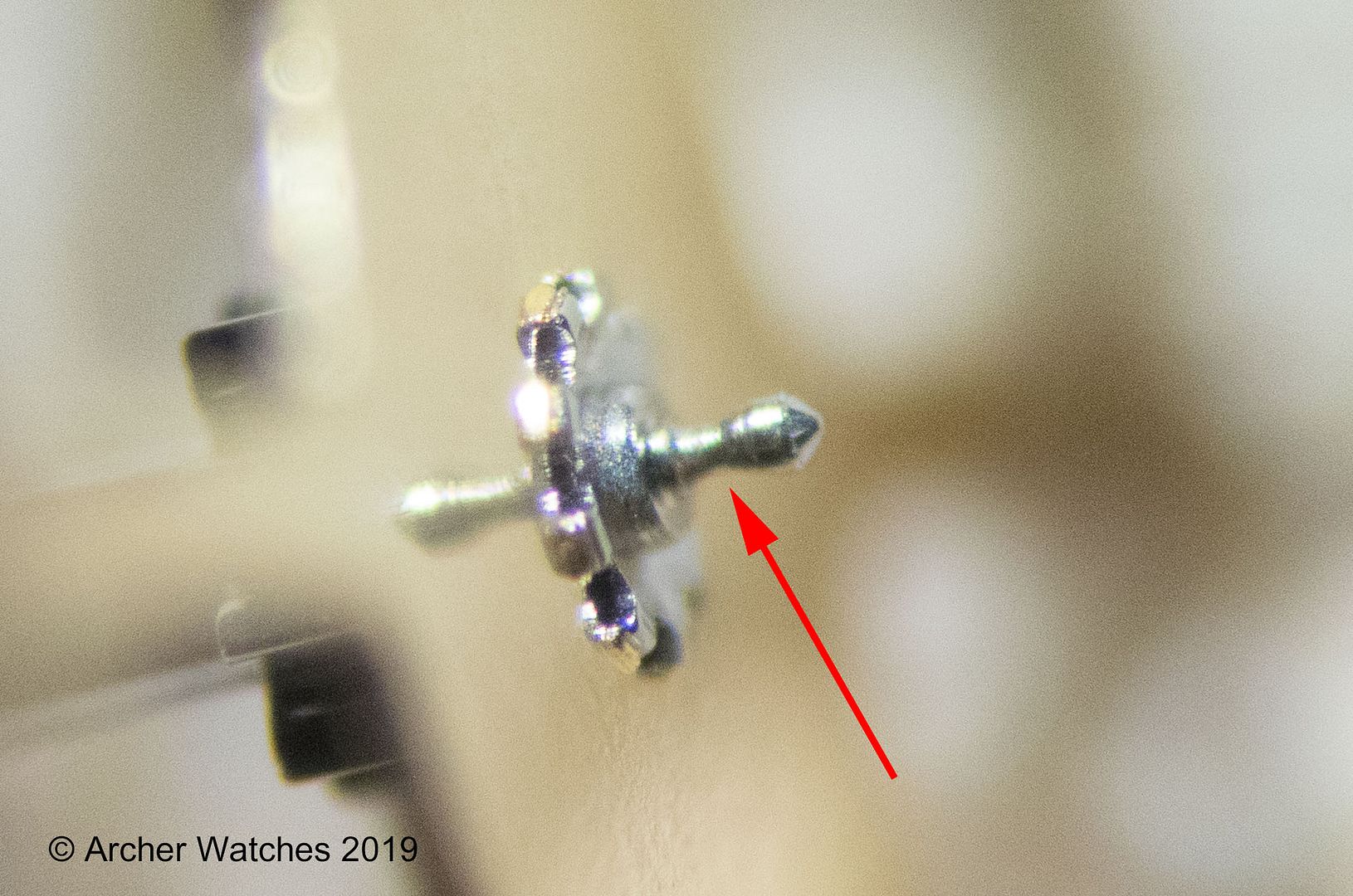

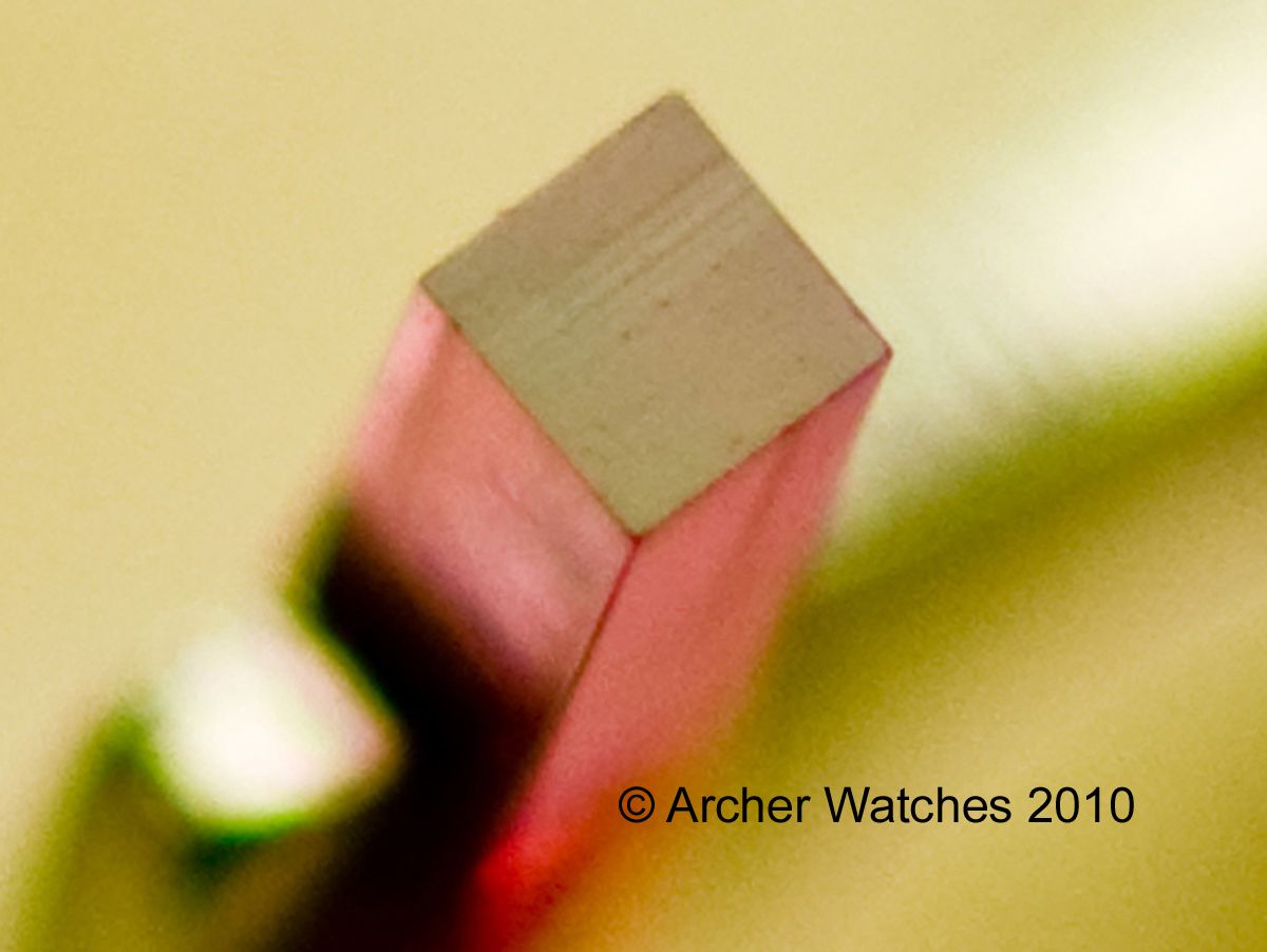

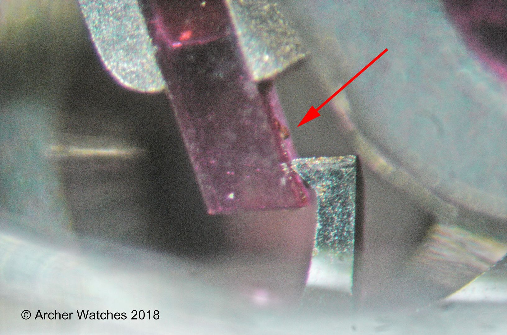

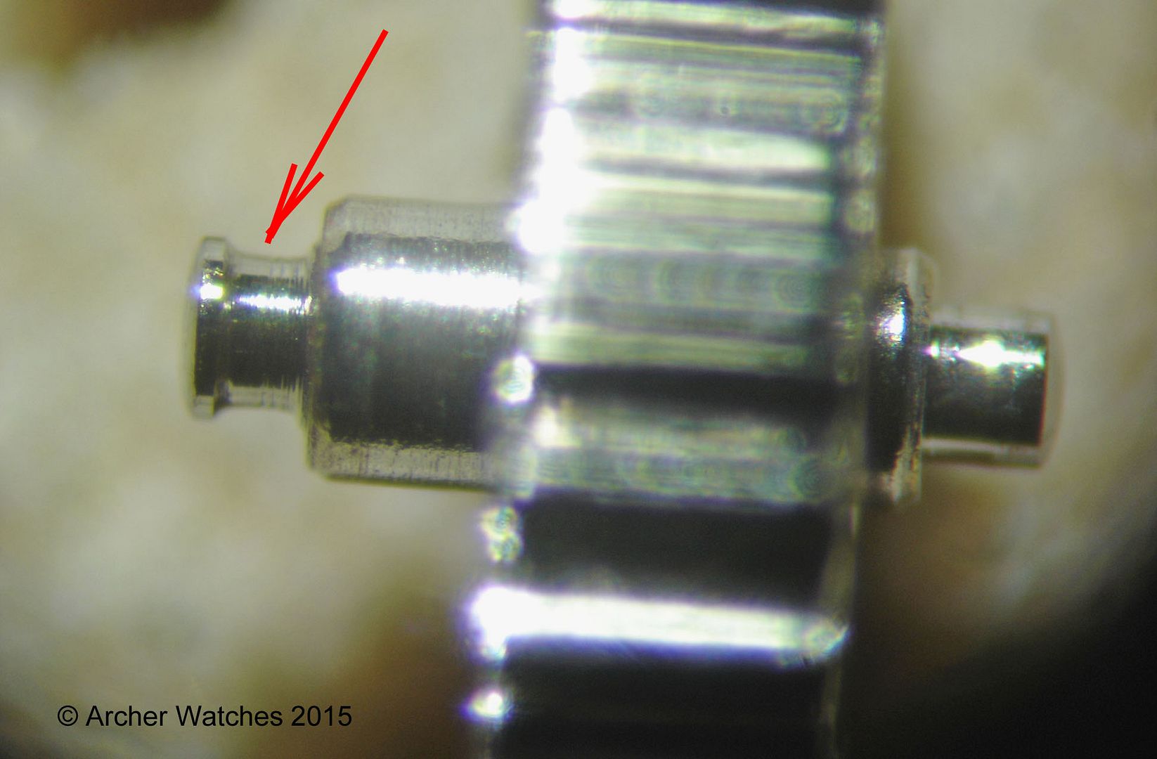

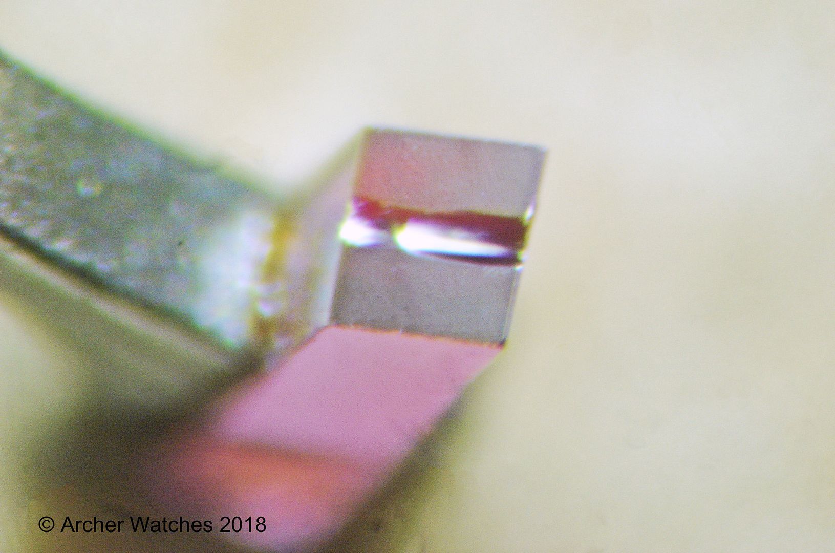

Just wanted to clear up a few things...
These movements are serviceable, and parts are available just like other movements are - if your local independent watchmaker is Swatch group certified, they would have access to the parts and tools needed. People who are saying that can't be service are confusing them with the Sistem 51 movements.
The synthetic escapements are lubricated, just like a regular Swiss lever escapement is lubricated. There's a specific Moebius lubricant used on these - TH7-001. So the idea that these are relying on "self-lubricating" plastics is really not the case.
I don't know of any specific issues with the synthetic escapements wearing out, but keep in mind that escapements with traditional hard materials also wear. You can see the wear in the impulse surface of this pallet fork jewel:

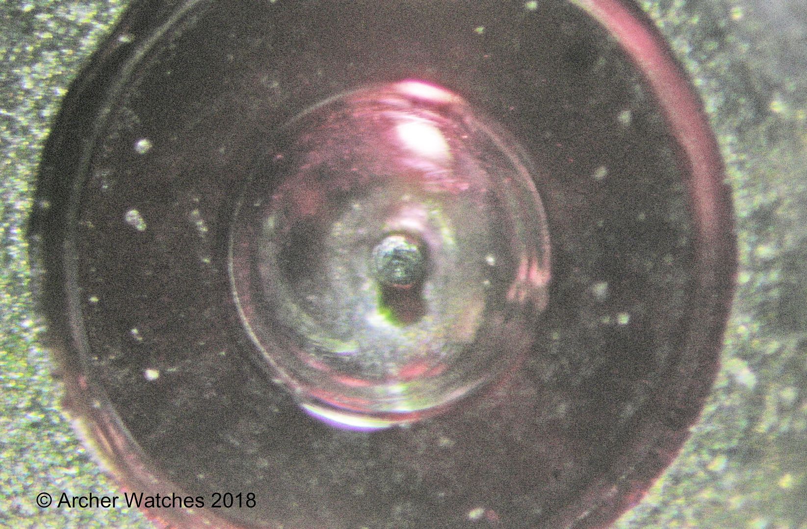

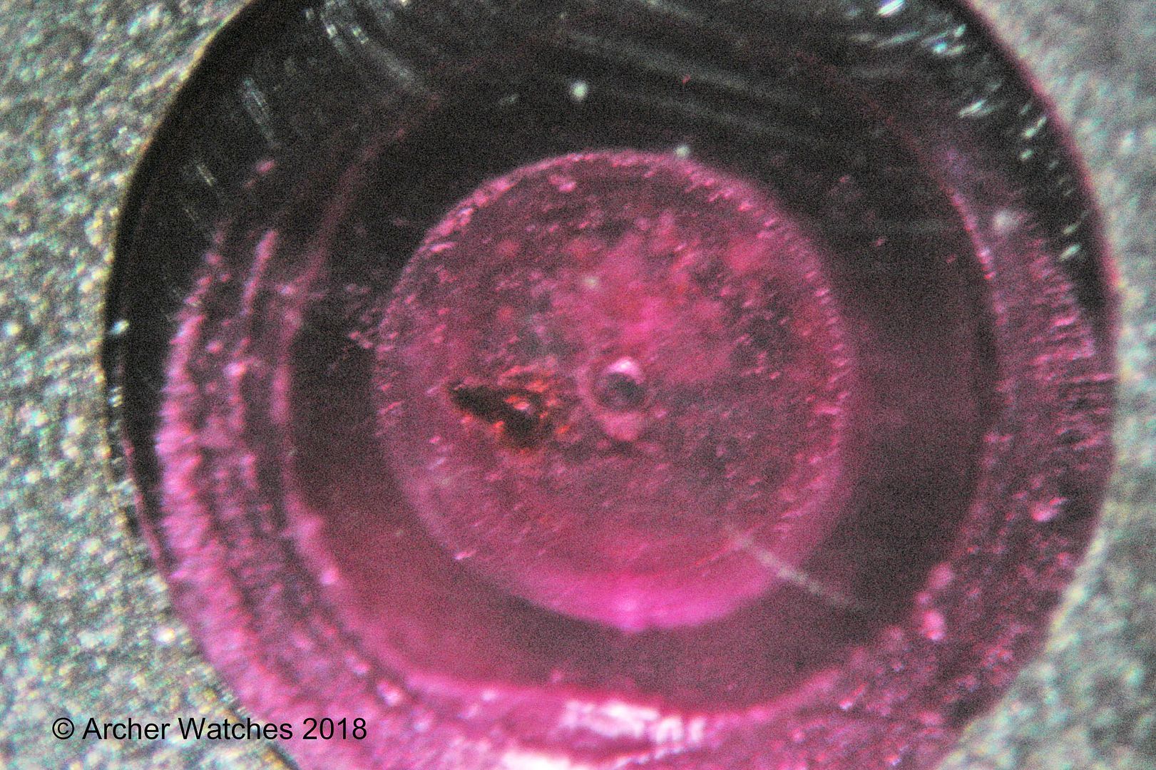

This is probably the worst wear I've ever seen on a pallet fork jewel:
Escape wheel teeth also wear, just from normal use, but even more so when there's damage to the pallet fork jewels, which are hard but also brittle. In this example this chip in this jewel:
Lead to a line down the middle of the escape wheel teeth - half the tooth was being scraped away:
In this example, these chips in the pallet fork jewel:
Lead to these grooves being cut into the escape wheel teeth:
So "harder" materials don't necessarily mean longer life. The loads in this area are large given the surface area of contact, so damage can happen even with hard materials. Steel on jewels causes wear all the time - pivots wear on wheels all the time when running in jewels - some examples:

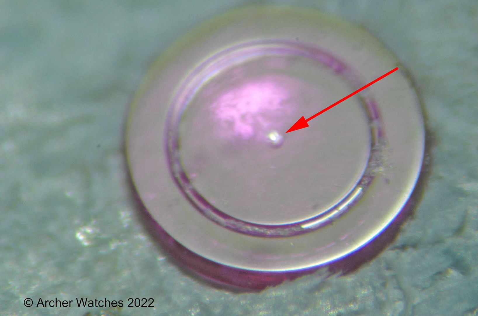

I regularly see cap jewels for the balance that have had divots drilled into them by a pivot of a balance, that is all of 8/100ths of a mm in diameter...
So what people may have experienced with materials in the regular world, doesn't always apply when things are as small as what we have inside a watch. If the materials are picked properly, then they will last an appropriate length of time before needing replacement, so long as the watch is taken care of.
Cheers, Al

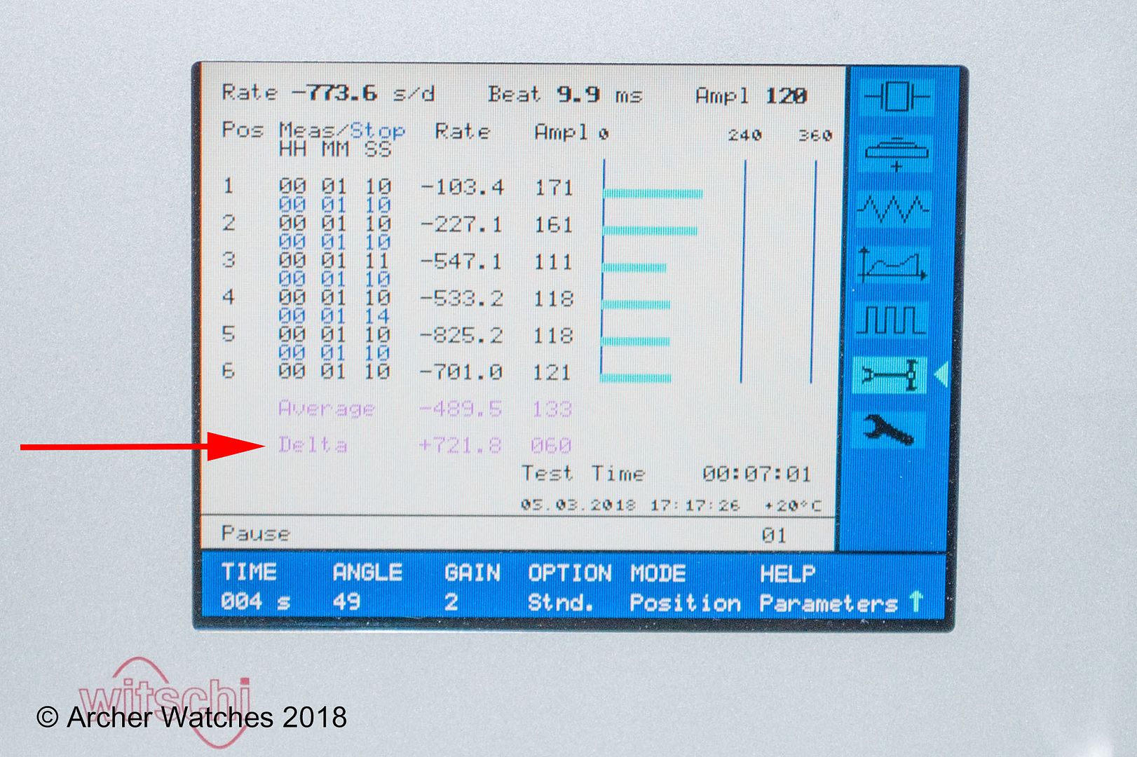

#79 ·

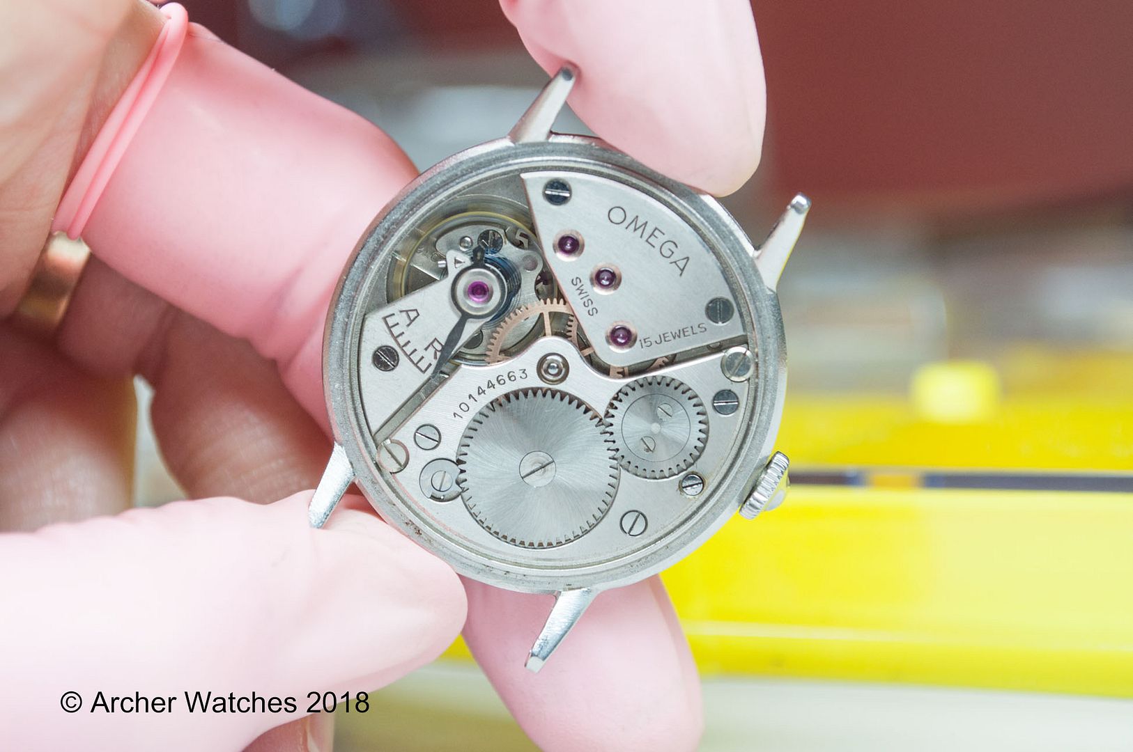

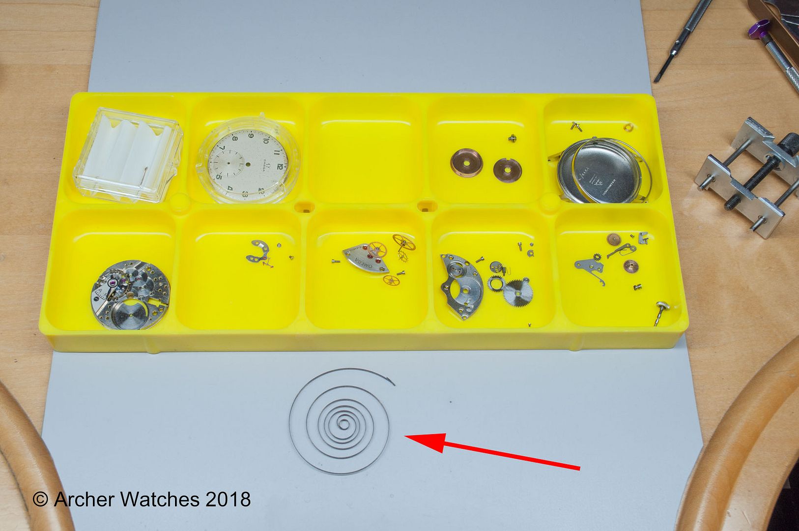

Take that second pallet stone. It would not even be capable of transferring power in that state
That particular watch came in completely dry, and not in a running state.
I promised to follow up and here it is. Going to eat my words a bit here, and show you something at the same time...
Looking back on this, more details have come back to me (I service a lot of watches so the details sometimes get lost - that's my defense anyway!) and this one had quite the story. It was supposedly serviced by a "budget" watchmaker, and it did in fact run, but very poorly. Here is the movement in question - running in this pic:

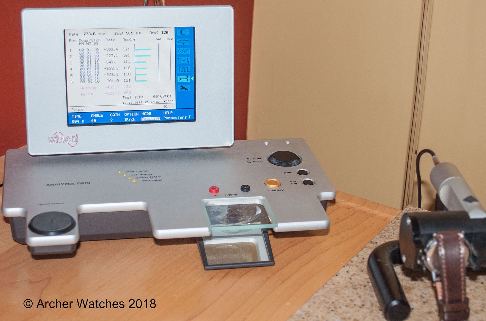

Here before I opened it, I ran timing checks at full wind over 6 positions:
Results are not good - low balance amplitudes all around, and the Delta (difference between the fastest and slowest position - a measure of precision) is huge at 722 seconds per day:

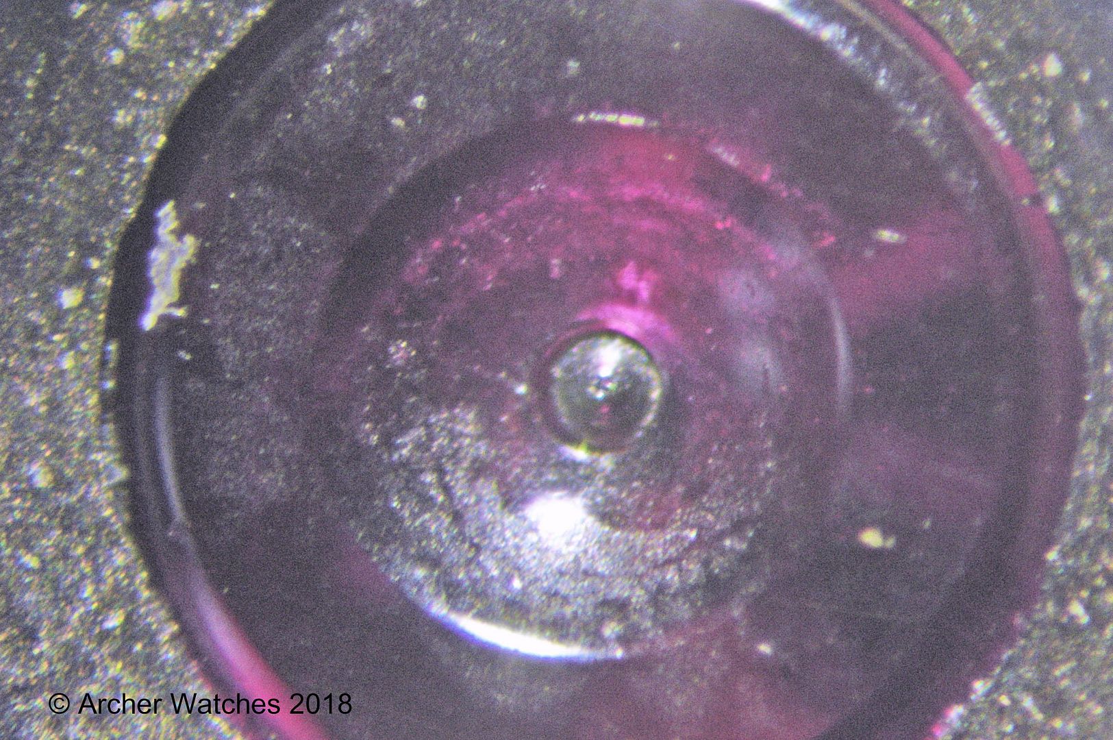

Movement was completely dry as these photos show:
This is a good illustration of what dried up oils and debris look like under the cap jewel:
Here's the escapement - dried oils and crap all over - the escape wheel teeth though look okay from what I can see in this photo:
Mainspring was set - old blued steel spring - these should always be replaced with a modern white alloy spring:
So contrary to my initial statement, and your expectations, this watch ran with that much wear in the pallet fork jewels, so it was certainly able to transmit some power. It didn't run well, but it ran.
I've been doing this a while and some days I'm still surprised at the stuff I see with these watches coming in...the customer that sent me this one sent me another that was serviced by the same watchmaker (this one had actually been serviced) and it ran even worse - the Delta on that one was 1055 seconds per day!
Cheers, Al
#80 ·
Cheers, Al
That's.....THAT'S 17.5 MINUTES! Holy crap! :eek:
