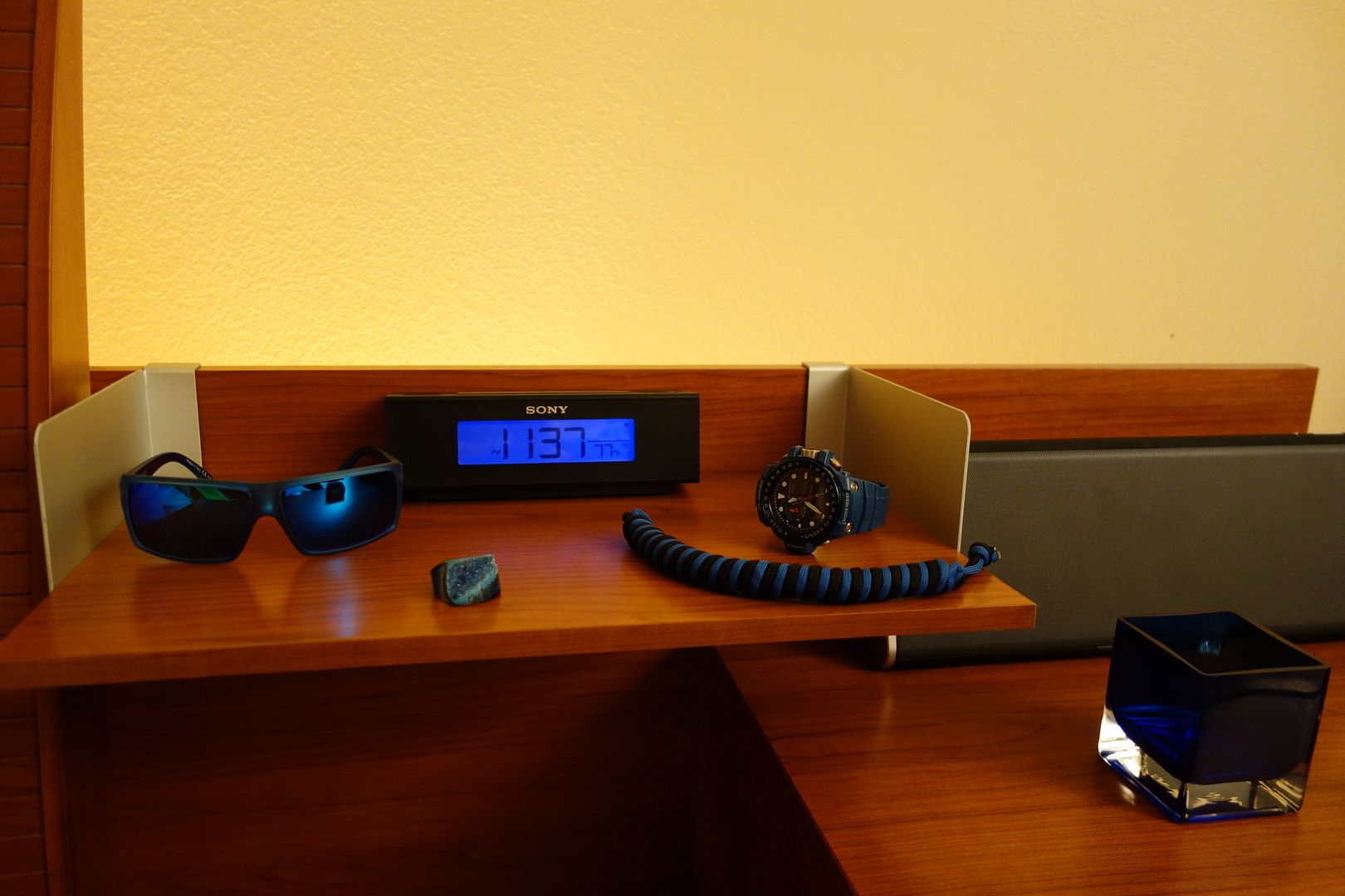

...well, it works like a charm for me, anyhow. I have a GWM5610 and live in central Florida. I'm quite a distance from Colorado Springs.
I was getting syncs about 3 times a week if I wore the watch every night while I sleep. That was acceptable. For whatever reason, I started not getting syncs in the last few weeks. Bad weather, possibly.
So, on a hunch, I did a manual sync with the watch draped across the clock radio next to my bed. BINGO. L3 displayed, and it synced in about three minutes time, at 6:00 in the AM. I did it again this morning, and it worked like a charm. As I said already. Like a frikkin' LUCKY CHARM.
I suppose it must be getting reception though the electromagnetic field around the clock radio somehow.
Anyway, you might want to try it sometime and see what happens, if you are not getting syncs as often as you would like.

Oddly enough, this little corner on my wife's dresser is 100% on syncing every night. The weird thing is that they are next to a wall on the west end of the house, with the closest window about 4 ft away.

They may be right next to some wiring in the wall there that acts like a signal booster.

Probably, because an atomic clock likely has a ferrite loop antenna that is tuned to the time signal station frequency (60 kHz for WWVB). If you properly position your watch's antenna so it is inductively coupled to the clock's antenna, this should help your reception. The trick is figuring out the proper position that results in maximum signal transfer.
