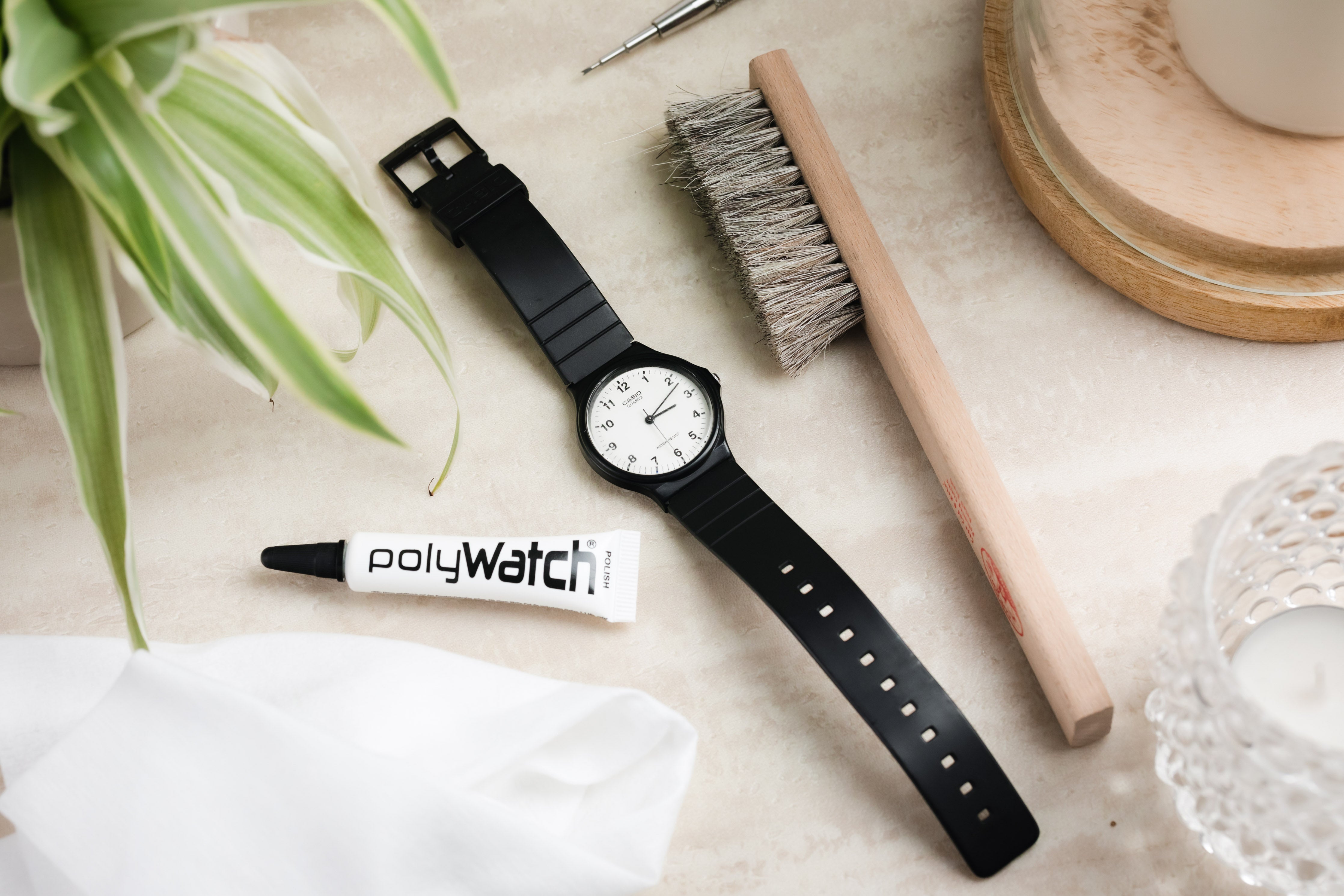

You could try a rotary tool with a polishing bit. I did that with the grey area of this Ironman. The results? Good from afar but far from good.
I've never used Polywatch.. but given that as stated before... given that plastic is plastic... acrylic is really another form of plastic. I've used this to experiment and worekd very well

IMO. the material your crystal is made of will determine how well it polishes out. Plastics will obviously be easier than mineral. Plastics will also polish easier with a less abrasive compound vs. something harder like mineral glass which will require something more aggressive.
If it was my watch I definitely wouldn’t rub it face down with a resin case (metal Case is more forgiving), not unless you don’t mind the case getting polished too.
